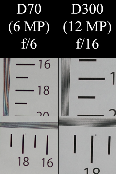

Or should I have tested at smaller apertures (maybe then I would have seen the difference (I rarely use f16 so I didn't feel I should test it)?
A long time ago I did this test and have found it useful ever since then. The bottom line is the diffraction impact is not as great as the resolution limit.
