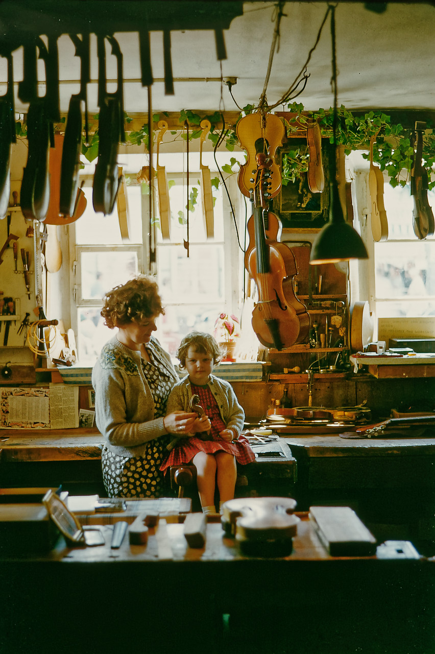

https://photos.imageevent.com/boophotos/europe1964/europe1964_2029emrd_sm.jpg
Wow Boo that's an amazing shot and one well and truly worth bringing back to life and preserving via a digital file, I'm in full swing now having scanned Hundreds of images with my setup, the editing is the thing taking the time and I will take my time with it
Hey what year was your image taken in, just looking at my mates images from 1971-1975 I'm blown away with the quality and am now starting to love and develop a passion for old camera gear
An excellent result, I can imagine what the slide looked like knowing how limited the dynamic range of colour reversal reversal film is. A real problem in Australia as we generally have very clear skies and thus very deep shadows in daylight situations.
I had something similar with the subject being in full sun beside and white wall and prominent in the frame was an open door leading into the gloom of her house (in Nepal). Projected the slide was OK but black shadows inside the house, loupe on bright lightbox same, but scanned and raw fiddled suddenly some interior detail was revealed in the deep shadows.
I have many hundreds still to go - I’ve only done a tiny fraction of my late father's collection - he was a pro with a prolific body of work. It perhaps took a week or more just to narrow them down to ones to keep to look further at - I'm afraid I’ve thrown away thousands already - we decided to keep largely only ones with family in them. I just wish Dad had got to see what could be done with them now - that I can improve exposure, clone out scratches and hair, do local adjustments etc. It seems that I can retrieve good detail from dark areas, but to a lesser extent from overexposed areas.
That image was taken at a violin workshop somewhere in Austria in 1964. The range I have start in 1955 with ones my Grandad took of their world travels, up to the mid 1980s. I was planning to do more over the coming winter - but they're quite poignant, so I have to be in the mood to face them - some are blooming hilarious though. I tend to do them in batches (maybe 50-ish) - shoot, download, develop and publish online, then do another batch.
