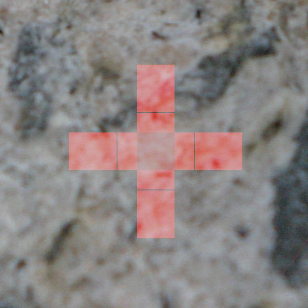

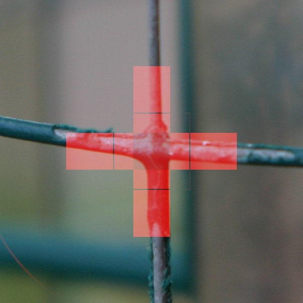

But, according to most, the focus region on the 10D is actually larger than the red rectangles. If this is true, than it most definitely could have chosen the tree trunk or the dirt/sawdust as they are definitely more contrasty than the saw blade.
Rgds
KR
Leaves and grass do not have the contrast that the tree edge has.
The tree edge is not in the focus region. The circle is NOT the
focus region. The red rectangles are.
No they are not. The actual sensor size is about 80% bigger in the form of a cross. This makes the tree in the focus zone. Do a search and you will find the info somewhere. It has been discussed to death on this forum. Perhpas ask DavidP or Mishkin and they will point you to the material.

You must look at the extended focus region. In this case, the subject is backfocused even if you consider the leftmost part of the focus region, which comes the closest to being in focus.
Your first example, where you focused at one zoom setting and then zoomed to the other for the snap is not a good example. Why? Because when zoomed wide, the focus region includes much more of the subject, including, presumably, a portion that is in focus.
The second example is illustrated here. It shows quite clearly and unambiguously a focus problem. Of course, this assumes you didn't focus on something else and then pan for the shot.
This is not a good example because of all the other stuff not in the focal plane. The camera could have legitimately chosen any of the twigs, etc. that are in the focus region.
It doesn't seem to happen the same way all the time. The first shot looks like it chose left of center (possibly for the more painted then chipped section). The first rock is totally out of focus, the second rock is focused on the more contrasty v cutout of the rock. However, the squirrel shot seems to me to be focused on the right of the squirell on the more contrasty small tree branch, which actually starts off slightly in front of the squirrel. This would only seem to support the focus area being larger than the red rectangle theory.

And I don't think they bode well from my problem...
All of these pics were center focus point selected and focused off
of without reframing with one exception which I will explain later.
Full Image: http://www.pbase.com/image/23667311/original
Focused on the center, but the further part of the cage to the left
is in focus. No more contrast there than there was were the focus
point was.
Two pics of a rock: The first was taken focused at 70mm then
zoomed in to 200mm to take picture. The second was focused and
taken at 200mm.
Full Image Rock 1: http://www.pbase.com/image/23667313
Full Image Rock 2: http://www.pbase.com/image/23667316/original
Notice on the second rock that the center, which has just as much
contrast as the top part (or farthest part) is blurry and the top
is sharp.

So, am I crazy, or is this backfocusing?
