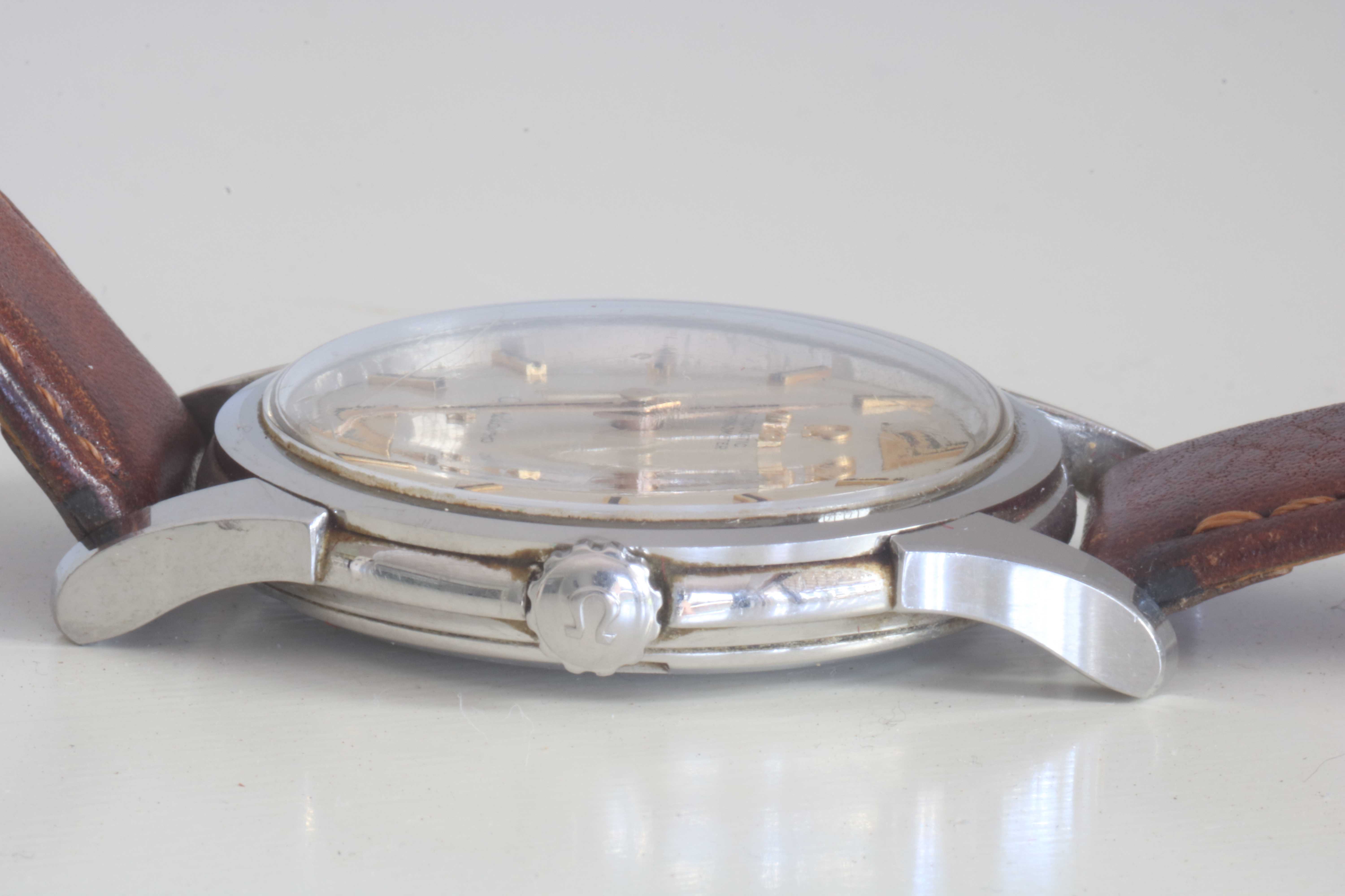

I took this photo using a Canon 750D glued to the Sinar. I posted it in the macro forum and it seems it's not an extension of DOF. Wouldn't work for birds anyway. Might be useful for flat fish or snakes or whatever.
Used about 15 degrees forward tilt on the lens plate.
Watch needs a clean.
