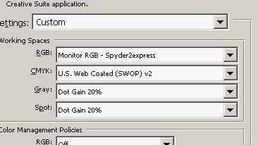

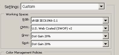

If I decide to PP my images as aRGB in PS, should I change PS
working space to aRGB? Seems like I would half to if I wnat to PP
aRGB images.
Like alfredky said, this is much related to what you're going to print to.
I've checked on MPIX web site, and there are taking only sRGB for their printer. They seems to make an important place for color management, since they communicate on this at the first level of their website.
However I guess that they are using Frontier/Lambda to issue all paper prints, so this sRGB limitation is a little weird. From what they say in their FAQ page, they seems to check calibration on a regular basis (as all labs), so they must have each printer profiles somewhere. What is weird is that they don't give them. I think that probably they want to have the less problem, given that almost everybody must be editing in sRGB (without knowing it maybe), and they had less return. Also this means that every sRGB image with unchecked ICC box will be assigned the sRGB profile, which does not change the picture look in the end.
aRGB images.
print to.
their website.
Thanks for checking I should have done this myself. But until recently I really didn't have a need to. What I had printed turned out pretty close to what I see on my montior, except for being a little to dark.
Not sure, you seem to know way more about this then I do. So assigning the image to sRGB profile does not make the image a sRGB? Maybe answering the question below will clear things up.
