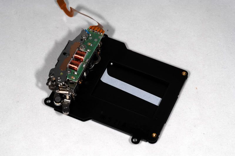

It's related to the speed the shutter blades are moving and smaller blades
can move faster and there is less distance to move. Larger heavier shutters
with a long travel have to resort to the "running gap" already at slower
shutter speeds and then the sensor will not be evenly luminated by the
flash.
blades can move faster and there is less distance to move. Larger heavier
shutters with a long travel have to resort to the "running gap" already at
slower shutter speeds and then the sensor will not be evenly luminated by
the flash.
What are shutter blades and how do they work? I thought there was only a mirror on a DSLR. There's no reason a big mirror can't move as fast as a small mirror, but, as discussed above, that implies greater mirror slap.

Nikon was first with titanium shutter blades, they did that for a reason, less mass moves faster
I still don't know what shutter blades are, though. Are they what
hold the mirror?
i uploaded this for Joseph Wisniewski before
although thats the Copal M8 shutter off a Leica M8, in principle they are all the same. The blades move both up and down to expose the sensor, the faster they move the more shutter speeds you have. I think the M8 is going to 1/4000th, E3 has 1/8000th already. Blades moving at 1/4000th used to be the cutting edge of technology. It couldnt be done with shutter curtains (another variety with a fabric shutter) or steel or ally, so they went to titanium for high strength/weight. Its important they remain quite rigid too, things tend to get very plastic at those speeds
