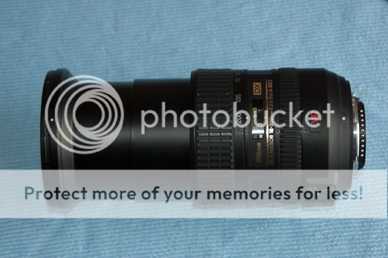

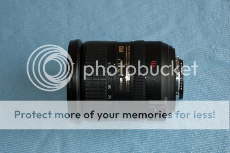

Fixing my 18-200
:) There was a tiny bit of crap in the lens mount spacing rings which was throwing the image plane slightly off.

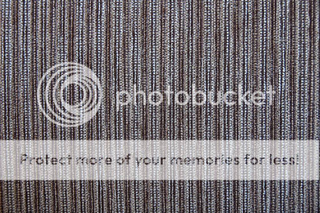

This might be a better indication of the sharpness.
The corners are a still a bit fuzzy...
I think that they need those alignment jigs only to seat the glass. This was definitely a very lucky way for the lens to break. I didn't have to really shift any glass to get to the broken parts and all the electrical was still in tack.
I'm happy with the result and for a free broken lens, you can't really beat that price.

Congratulations! The image of the fabric looks pretty sharp. Corner softness is normal in lenses so perhaps that isn't because of the repair. Thanks for sharing this adventure with us. Peter
Thanks Peter,
I my curiosity was too great to pass this opportunity and I'm glad to share it so others can see.
You are also right, I talked to someone that actually owns a super zoom and they said softness around the lens is normal.
