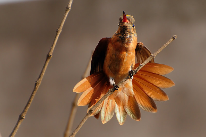

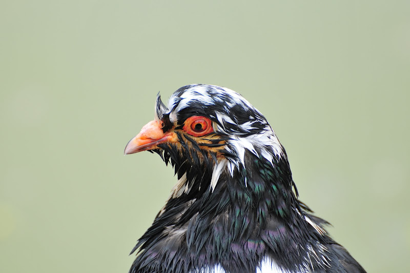

Ron, my experience with my 70-300VR has been very positive, sharp results even at 300mm., better if stopped down to 7.1 or 8 (but then you need decent light). but VR is very effective and you can shoot at quite low speeds.
I always shoot JPG and use some PP sharpening, here are a couple of samples so you can compare with your results. both at 300mm. handheld. VR on, f/7.1 and f/8 respectively, cropped about 50%:

OH man I can't beleive this, over a year suffering, I never considered the UV filter. It looks so clean and nice to the neked eye but...
the results speak for themselves. It's like I got a new lens!!!!
Thanks so much for the suggestion on that!! :-)
check this out!!
200mm F8
300mm F8
300mm F8
300mm F5.6 !!!!!!
300mm F5.6 also
I cannot believe this, I'm happy and ticked I suffered so long. Mostly glad my lens actually is ok though!!
Thanks again so very much!
