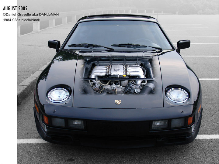

You need to isolate your subject in post-processing:
Digital Camera and Adobe Photoshop user since 1999.
Adobe Lightroom is my adult coloring book.

Lose the background.
In this case, a higher viewpoint would work... A ladder maybe?
On the PP side, a close cut and lighten the background like this perhaps.
