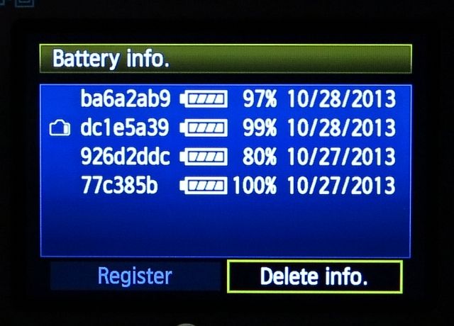

Unless I am mistaken, isn't the serial number displayed in the camera's "battery status" screen?

The individual hexadecimal serial numbers are displayed when you register the battery to the camera. Genuine serial numbers can be both 8 digit and 7 digit. There are some 7 digit serial numbers that are fake but they will often share a common serial number.
bca8a8d is a known fake serial number you might see. mh27866 was reported as fake in a forum post once but it was probably a mistake since "m" and "h" are not hexadecimal numbers.
These are all genuine serial numbers

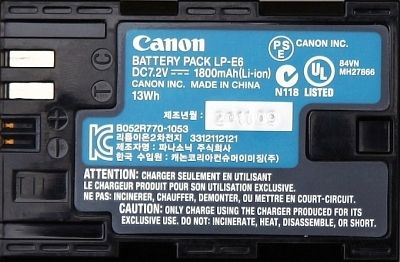

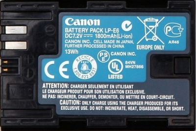

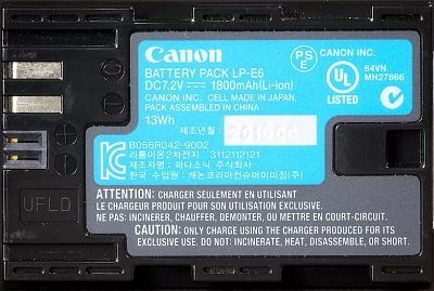

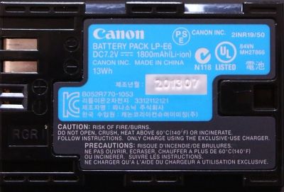

Here are 5 different label types with some showing the stamped date of manufacture.
