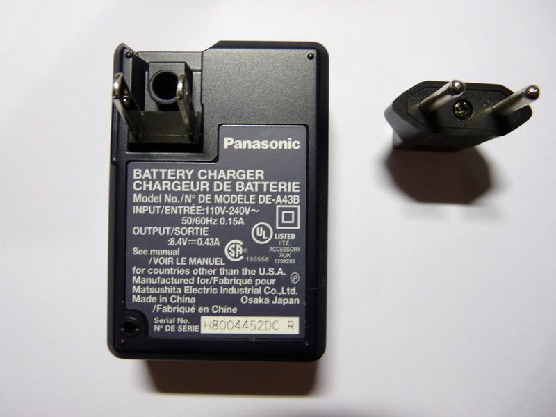

I will be travelling to Japan next week. Checked the ratings on my charger, it says 110-240V. Japan is on 100V. Do you think my charger will work fine on this? Is there any sort of adapter I need to buy?

in europe the adapter and plug look like this: (We use 220V.)

Yes, your battery charger will work just fine, and the plug adapter is the same. While your charger is listed at 110/220 and Japan operates at 100, all it means is that your charger may take a little bit longer to charge, and you're certainly not over-charging it at 100. I have been to Japan many times over the years, and I know from experience that camera battery chargers, electric shavers, etc., all work fine in Japan.

I live here. You will have no problems.
I don't think charging time will vary because these are all using voltage regulators anyhow. It is not like a transformer that outputs a ratio of the input.
Most appliances will operate no problem at plus/minus the nominal voltage stated.
However, it is a little weird - all the multivoltage stuff I have ever bought has a range of 100~240volts that will cover any global travel.
