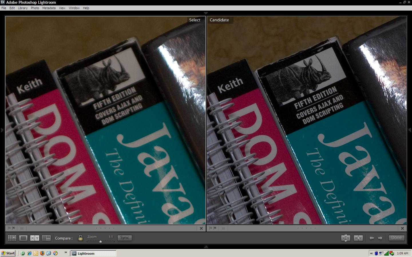

I ran the same test at 5-7 feet. This lens shouldn't have any
problems at this distance. The images simply do not seem tact sharp
like some of my other lenses.
Agree. At that distance this lens should be quite sharp -- even wide open. Although it should be sharpest around f/4 in the center.
How did you verify focus at these longer distances? The focus test chart indicated good focus accuracy at very close range. At five to seven feet the AF might be off causing the softness when wide open.
When I ran sharpness tests with my D70 I used a focusing rail to tweak the distance between bracketed shots once focus was locked. With the D300 it's much simpler. Manual focus with liveview in tripod mode at 100%.
Steve
I am using a split prism focus screen. Focus is definately on.

I'm just eliminating possibilities here, but things aren't looking that good for the lens.
Split prism focus screens can be off. But I assume you would have noticed this with your other fast lenses.
Split prism focusing is not necessarily more precise than other methods. In order to work for f/5.6 lenses they don't take full advantage of an f/2.8 lens baseline. Additionally, split prism focusing can be thrown off by the spherical aberration in a lens.
I'd still do some slight focus bracketing. Or split prism focus on an element within a target that's slanting away. Then compare the sharpest point on the final image with the element you focused on.
Steve
Your focus points look spot-on. The lens is just soft wide open as mentioned by others. Try doing the test again but stopping down to f4 and see how that effects edge sharpness and contrast.

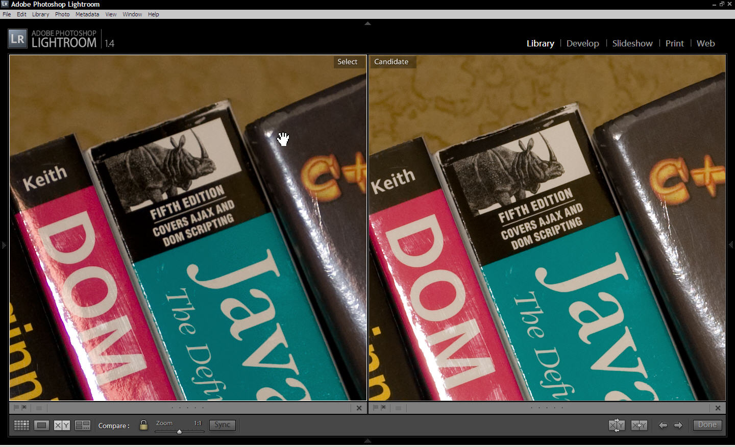

I guess my lens was simply crappy.
I receive a new version of the lens it appears significantly better. Center sharpness is virtually the same at f/2.8 and f/8.0.
New comparison:
Old comparison:
