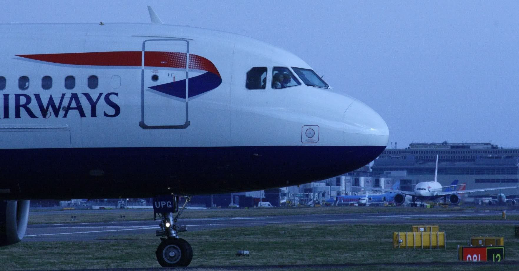

No i didn't please consider fact that I've been photographer less than a month but please feel free to express any advices because I am willing to learn on my own mistakes
Not bad but the white balance seems to be off. Meaning it looks too cool(blue).

It looks like you have your auto white balance set to manual according to the exif , you have a blueish cast , set it to awb outdoors . Also because the plane is white you might of wanted to give it some + exposure compensation , the first shot looks grainy you are using iso 1600 when you don't have to iso 400 would of been ok I think........ Lenny

The main rules: Use iso as low as possible; use shutter as fast as possible; don't use aperture smaller than f16 (evenF16 to be avoid); avoid wide open apertures; avoid lens extreme zoom positions (varies from lens to lens, though)
In this particular case you could easily drop iso 3-4 stops down (ISO100- 200) and avoid noise issues. Say, ISO200, shutter 1/400, F9. The IS feature gives you even more room to slow down the speed (assuming the plane was not moving)

Why f/18 and ISO 1600? Why the -1/3 EV? The picture is slightly underexposed, the WB is too cool, it's noisy due to ISO 1600 and there is softening due to the effects of diffraction due to f/18, sorry!
Setting it to f/5.6, 1/800, ISO 200, 0 EV would have given you the exact same exposure. I would have set the camera to Aperture Priority, set the aperture between f/5.6 and f/8, ISO 200 and would still have got a shutter speed higher than 1/400s.
For outdoor conditions, Canon's Auto WB works pretty well. Of course, shooting in RAW can help fix any WB issues during conversion. Keep practicing, good luck!
