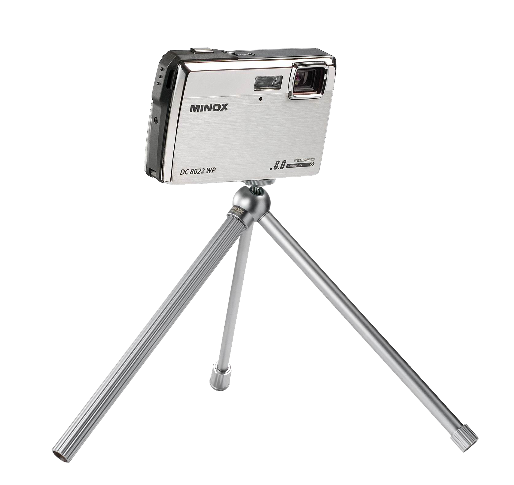

The Minox mini tripod is very compact thanks to its matryoshka style nesting legs and can hold a Leica M, but tightening its tiny ball head is a bit of a chore.

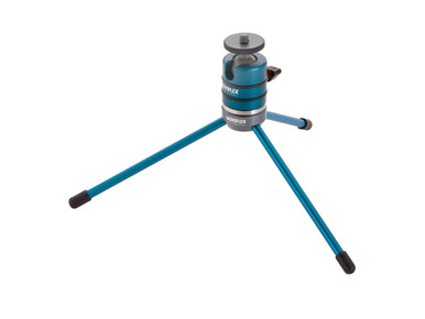

The Novoflex Microstativ is very good but not that much lighter than yours, although it does include a ball head.

What kinda setup would that small screw at the top hold steadily tho? I'm kinda skeptical it'll be better than the Joby Griptight Micro (can't tell if the one on your site is the smaller 250 or the larger 800, looks like the former, Joby has been pretty sloppy with ambiguous naming and branding lately IMO).
https://novoflex.co.uk/consisting-of-micropod-and-ball-20/
Yeah that's basically the only interesting option I've found on my own (see my second comment), it's not a lot lighter but I think by detaching the legs it'd be more pocketable. I've seen complaints about how easy it is or isn't to attach them, what's your experience?
https://www.minox-optics.com/uk/MINOX-Camera-Pocket-Tripod/80405773
It'll hold my Leica M with 50mm lens. The ballhead is tightened by turning one of the legs that screws into it, and it's hard to get enough leverage to torque it fully, and they didn't think to put a hole in it that you could insert something like an Allen wrench to get more leverage.
In any case it's probably an academic question as it seems to be discontinued or out of stock everywhere.
There are two sets of holes, one that splay the legs at the angle in the photo, the others that are meant to hold the legs straight together while the tripod is packed. I have the old model with black legs and no rubber tips at the feet, so I don't know how much it's changed, but the legs have some sort of hard rubber or-ring at the tip that provides some friction. The plastic platform on mine broke, the screw will still fit in a tripod socket hole on the camera but it's not ideal.
Interesting, I would've thought the platform was metal like the legs, it broke from use?

FWIW the way I'm carrying it is this, I take off the legs (which you'd have to do every time anyway so there's no point in storing them attached and straight) and I throw em in a Ziploc in the tablet pocket of my PD 6L Sling... That means they're essentially taking up 0 space! That pocket barely budged after I put them in, I actually slipped them in standing so they're vertical against one side of the bag (and along a lens).
Then I take the small center spider with my chosen ball head and I just throw that in the front pocket of my bag. Easy peasy, it's a decent sum to spend on a tripod like this vs a Manfrotto Pixi, Cullman Copter, or a Sunwayfoto for half the $ but it neatly solves a pretty unique dilemma and can be carried with less centralized bulk than any of those.
I'm using a Sunwayfoto PMB-18 head on it, looks bulky in photos but once you turn the stem into the portrait drop slot it's flat-ish, and has the great advantage of having the pano rotation above the ball (and being much easier to lock in place with the lever while holding my desired framing than the average small ball head with a knob).
Saw the thread was active so I just figured I'd give an update, the Novoflex Micro and that Sunway head easily handled my A7R IV + 400g 17-50/4 for some video needs I had, and have traveled halfway around the world in my 6L Sling with me barely noticing I've got them in there.
