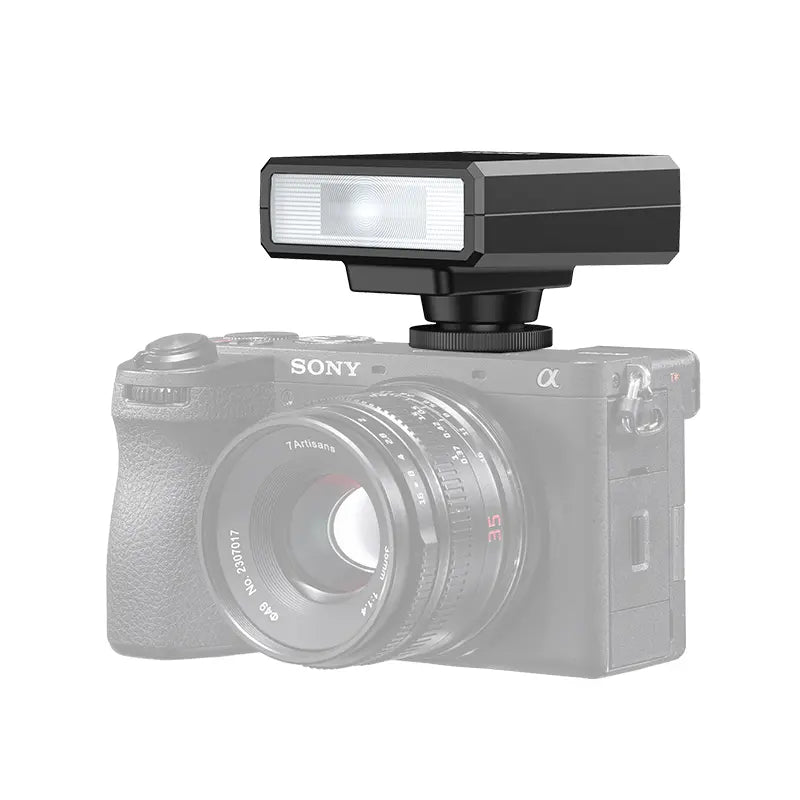

I'm not planning on putting the old flash on the camera. I want to put a NEW small flash on the camera so it can trigger the old one as a slave. ;-)

I just need it to trigger the old flash. The smaller the better, as long as it's strong enough to trigger the slave.
Something like this? https://reflxlab.com/products/pre-order-reflx-lab-mini-flash I'd suggest searching the Chinese market, I'm quite certain they have similar flashes for not a lot of money. All using internal li-ion batteries charged via USB-C.
Did a bit more searching, found this: https://www.aliexpress.com/item/1005008222329350.html
Yes, I also found those. The reflxlab one is out since it's too expensive for what it is (compared to the Godox for instance), and shipping is added too.
Ulanzi also has one that's similar in size and weight to the Godox. It's a little less bright but has an auto mode.
