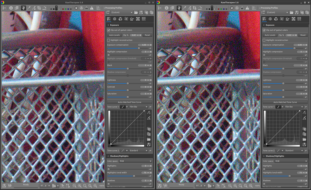

The bit depth may decrease with high speed continuous shooting (which I rarely use and haven’t checked), but my X-T2 and X-T20 ES files are 14 bit in normal single shot mode with the ES.
Couple of years ago, I did a test with my X-T20 and could not find a huge difference in dynamic range between ES and MS. A certain difference was visible, however. It was not a scientific test, just a quick experiment.
https://www.dpreview.com/forums/post/64307905
I haven't done it with my X-T4.
