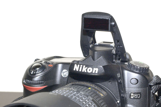

But ... I took the mod just one step further. I also replaced the pop-up flash lens with a 700nm Near IR plastic filter from Edmund Optics. Now this plastic filter is actually good enough to be used on the sensor. I previously modified a Nikon D50 using the Edmund filter - it cost a whopping $7.00 plus $9 shipping.
http://www.edmundoptics.com/onlinecatalog/displayproduct.cfm?productid=1918
On my D80 (I call it the D80ir) I now have an IR filter on the sensor and an IR filter on the flash.
This just completes the package for me. I can take pictures in a completely dark room without anyone seeing much of a flash at all. This is very cool!

I do not have any details in here yet for modifying the flash - but it's a simpler process where you simply remove two screws from the bottom of the flash - push the flash down and just lift off the top. You can then remove the current lens and replace it with a plastic filter cut to size. I used the Edmund Optics filter. I also used a black silicon caulk around the edges to seal out the light.
