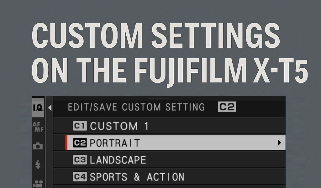

No problem, I got it from here:
This is one of the sources I found when trying to figure out and better understand my new X-T5, as it is a little different than my X-T3.
