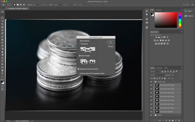

I believe it is because Photoshop did not pick up the layers to stack the focus. But How can I do this? I used this method:
PS04-focus-stack-blend

Looks like you are using Photoshop properly: stack the individual layers, then Auto Align, the Stack Images. Certainly for getting started with stacking Photoshop is okay. It gets terribly slow when the number of slices gets high (maybe more than 25-40, depending on your computer). Yes, Photoshop does not handle artifacts (ghosting) as well as Helicon and Zerene (both of which have free trials). But many times the difference between Photoshop and standalone programs is subtle, requiring 100% views to see the difference.
I think initially, perfecting the focus bracketing aspect is most important. If you will be doing focusing stacking a lot, then you may want to indulge in Helicon or Zerene. With their free trials, maybe try running your existing files through them and see if you can detect a significant difference compared to Photoshop.
