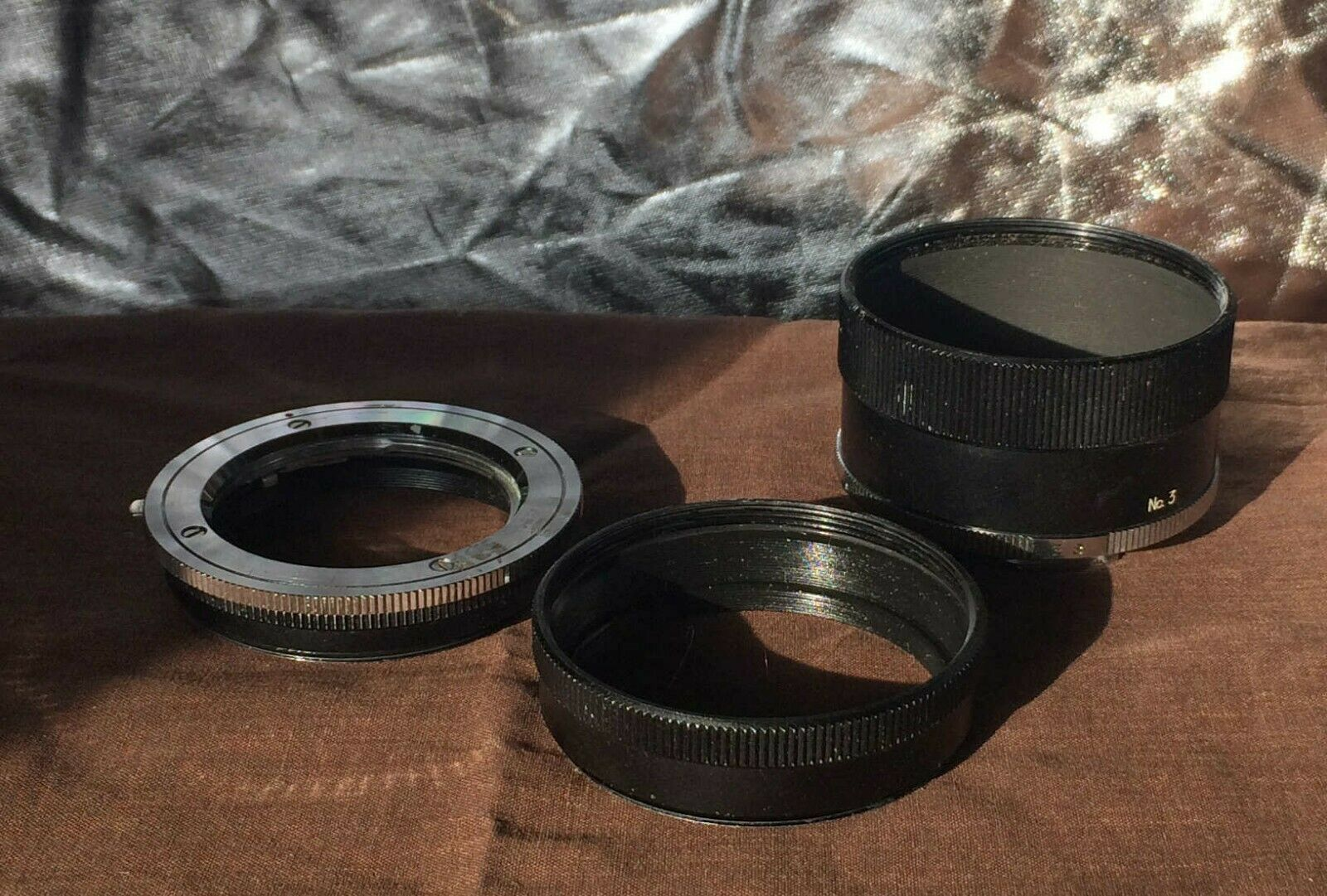

You might be best off getting a set of Minolta MD extension tubes, often vintage, which are threaded on the rear, and hope it's a usable filter thread/something you can get a step ring made for:
Then attach to an Olympus OM reversing ring.
I have a set of Konica AR tubes like this, also vintage.

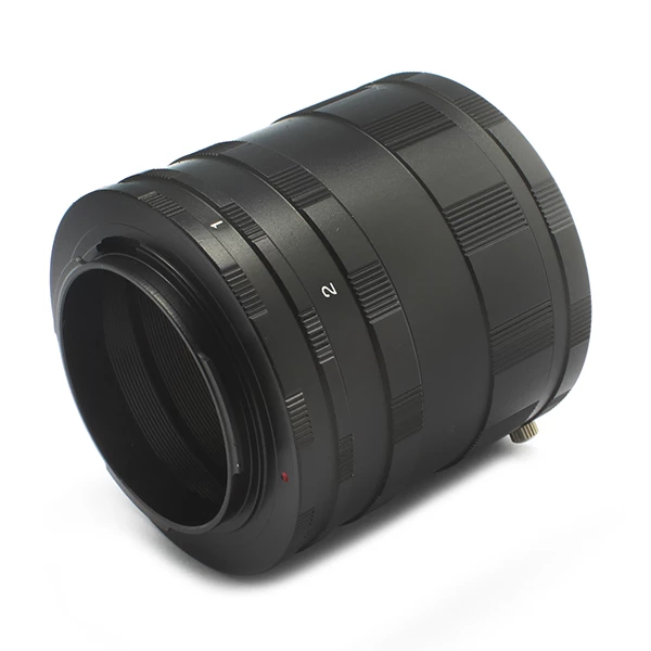

On a little further investigation, it turns out they do make those modern, cheapo threaded extension tubes for Minolta MD mount too:
Pixco Macro Extension Tube For Minolta MD/MC Camera Specs are based on 50mm f1.4 lens
£6.23/8.38USD. Same as before, use the threaded side to connect to an OM reversing ring, step ring might be required. As reversing rings are 'male' by default, the inner threads of a step-down ring would probably have to be used.

That's probably a workable solution .
If I haven't already got an OM reverse ring ( I might well have in one of box of bits !) There about £30 .
I've a few sets of early SR extension tubes , I think one of them might be the type that screw together . If not I can probably pick one up for less than £10.
Joining the two might need a stack of 49mm filters with the glass removed to extend the Reverse rings thread and expoxy into the tubes , as there both male threads .
Or SRB might do a double female thread adapter .

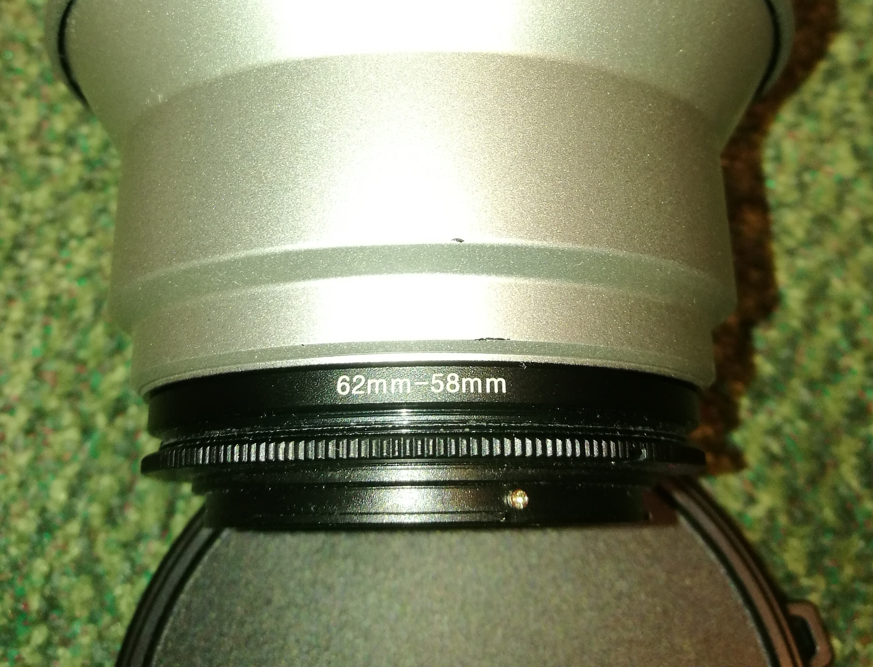

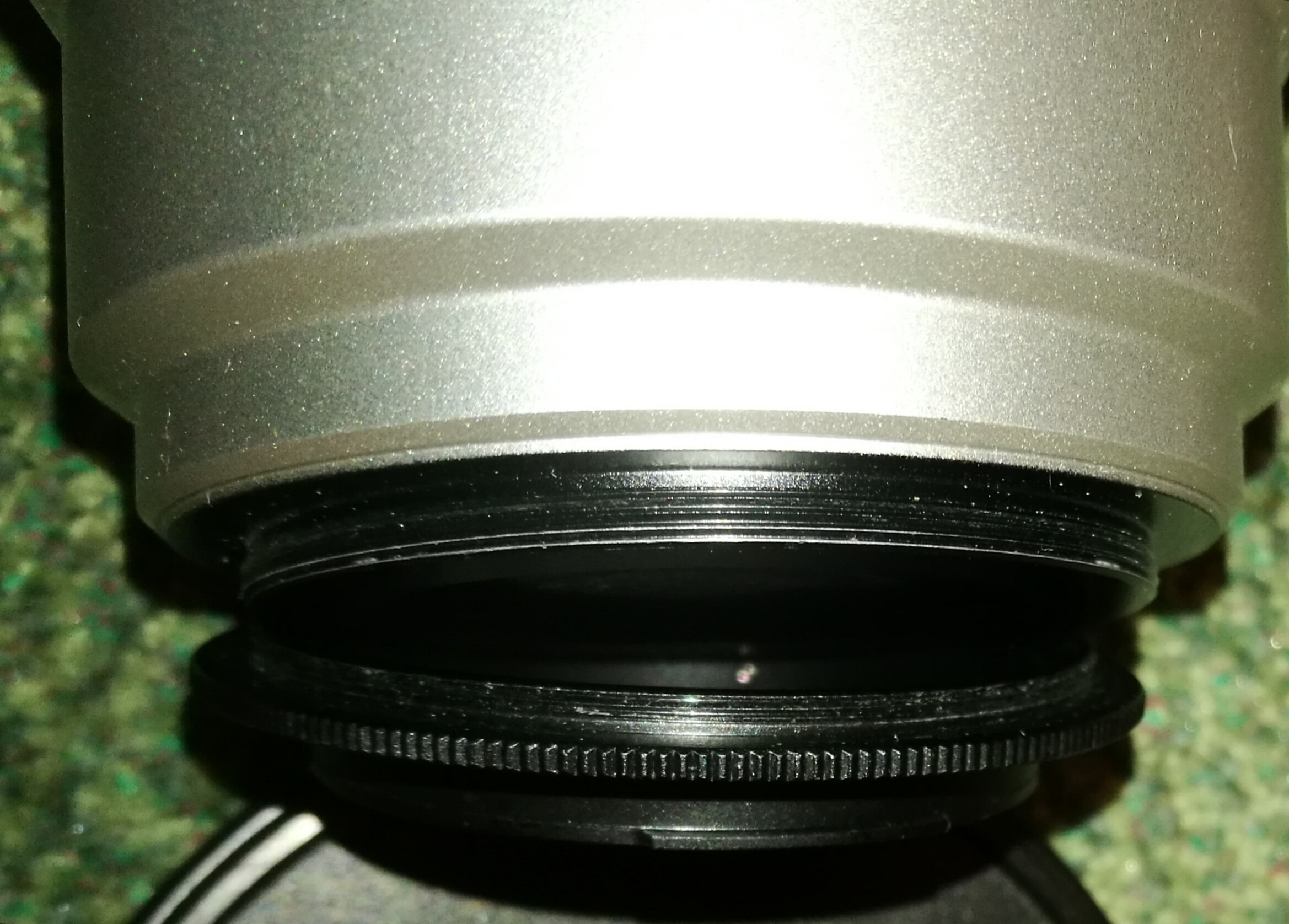

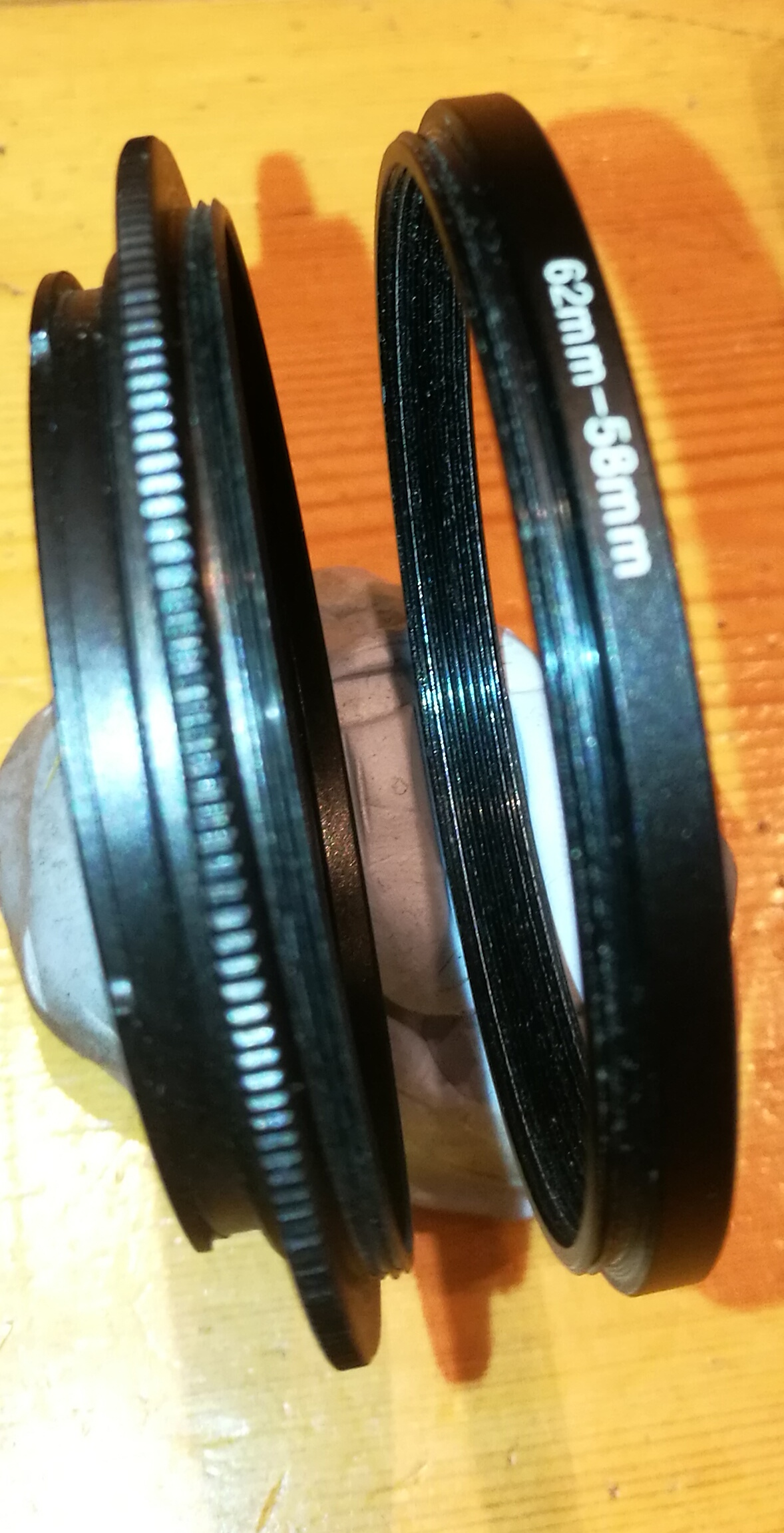

No need to pop glass from a filter, you can join 'male' threads together with a common step down ring. That is, one which steps down to the thread you're working with, e.g. 62-58mm, because when you're going to the next one down it will usually have a constant inner thread. Like so:
Problem- two 'male' 58mm threads. EOS reversing ring.
Solution- 62-58mm step down ring.
closeup of 'constant inner thread' of step down ring
You probably already have this to hand.

The type you show has a locating pin socket to lock it onto the camera .
With the manual focus OM cameras the locking pin is built into the lens , this type shown in the picture is the type used on the later autofocus SLR's , such as the OM 101 .
Either they've used a generic stock photo in their listing or they have listed it wrong .
The type of revering ring needed is the more expensive one like this ; https://www.ebay.co.uk/itm/291706238104?hash=item43eb0bf498:g:ocIAAOSwh-1W4sRe
Notice the push in tab towards the bottom .

I have got a load of step up and step down rings , so if the Minolta tubes do have a standard filter thread sized thread , it'll straightforward to fit .
If not I'll soon bond some together .
