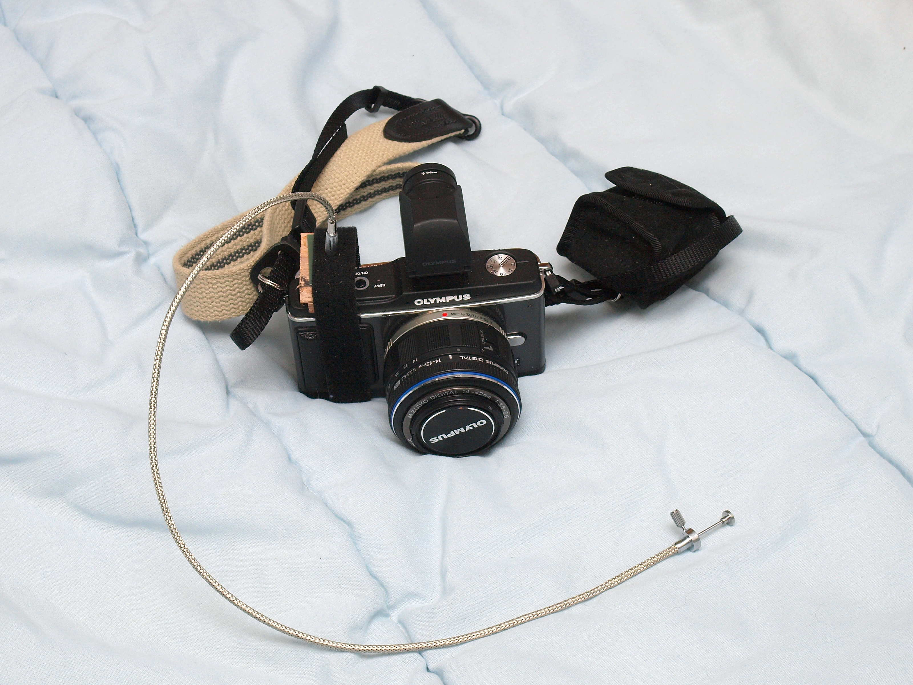

So your only solution seems to be modifying a film camera wired shutter release so that it presses down on the shutter button. I did this on my E-P2 when I couldn't use the RM-UC1 due to space considerations:
Olympus E-P2 + 14-42mm lens + homemade shutter release
