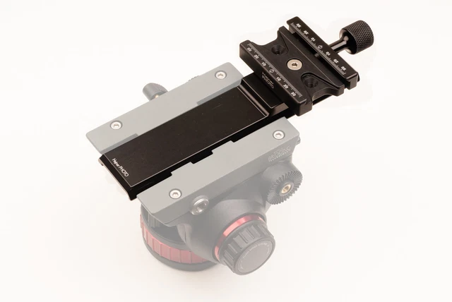

After a good deal of research I bought a 608 a few weeks ago - and immediately had to solve the problem of adapter plates/clamps!
Long lenses always have a longways Arca Swiss plate, so I made up this combination:
The plate is a Smallrig 501PL, and the clamp is this one: https://smile.amazon.co.uk/gp/product/B07WCVHP2Z/. 1/4" and 3/8" screws are provided with the Smallrig plate and I used both for alignment and security. It works well with my 600 and the RF 100-500.
The problem is, of course, that you can't use this with the L-bracket because the orientation is wrong. For that I mounted an Arca Swiss adjustable lever clamp, which I already had in my odds'n'sods drawer, onto the original Manfrotto plate. I don't have a picture of that one but there's nothing special about it. It does the same job as the Haoge item suggested by G Dickson, but with the handy lever and for zero extra cost as I already had the bits. This is the clamp I used: https://www.amazon.co.uk/gp/product/B078H2N8J6
BTW the 608 works really well with the damping set to zero, as a pan/tilt head for stills. It's so close to a gimbal that I'm seriously considering selling my Wimberley.
One last comment. To get the best out of the fluid head you will need a very solid tripod - that may have to be your next purchase!
The problem is, of course, that you can't use this with the L-bracket because the orientation is wrong. For that I mounted an Arca Swiss adjustable lever clamp, which I already had in my odds'n'sods drawer, onto the original Manfrotto plate. I don't have a picture of that one but there's nothing special about it. It does the same job as the Haoge item suggested by G Dickson, but with the handy lever and for zero extra cost as I already had the bits. This is the clamp I used: https://www.amazon.co.uk/gp/product/B078H2N8J6.

I was thinking about attaching two perpendicular Arca Swiss clamps on single (little modified) Manfrotto plate with screws. Do you think that is a good idea?
I thought a bit about it, but did not find a reasonably priced one. There was one from Kirk and it was $130-160.
Which product are you using? Sounds interesting.
I am planning to get 608 head and looking for solutions. I have EF100-400 II with replaced foot ( https://www.kirkphoto.com/replacement-lens-foot-for-canon-ef-100-400mm-f-4-5-5-6l-is-ii-usm.html ). Perhaps I could use something like this:
... with additional clamp like one Steve suggested.

What connector/adapter would be appropriate to connect an R5 that has a SmallRig L Plate attached?
In my case that wouldn't have been possible, because I have a 600 with a replacement foot which is like having a 120 mm long Arca Swiss plate, with the balance position shifting for the 1.4x and again for the 2x, or if I mount accessories such as an external power source or recorder. The crossways clamp would just get in the way. Also I like the arrangement I pictured above because it's impossible for it to twist.
Consequently I haven't tried anything else for the RF 100-500 or EF 100-400 - maybe your idea could work for that.
