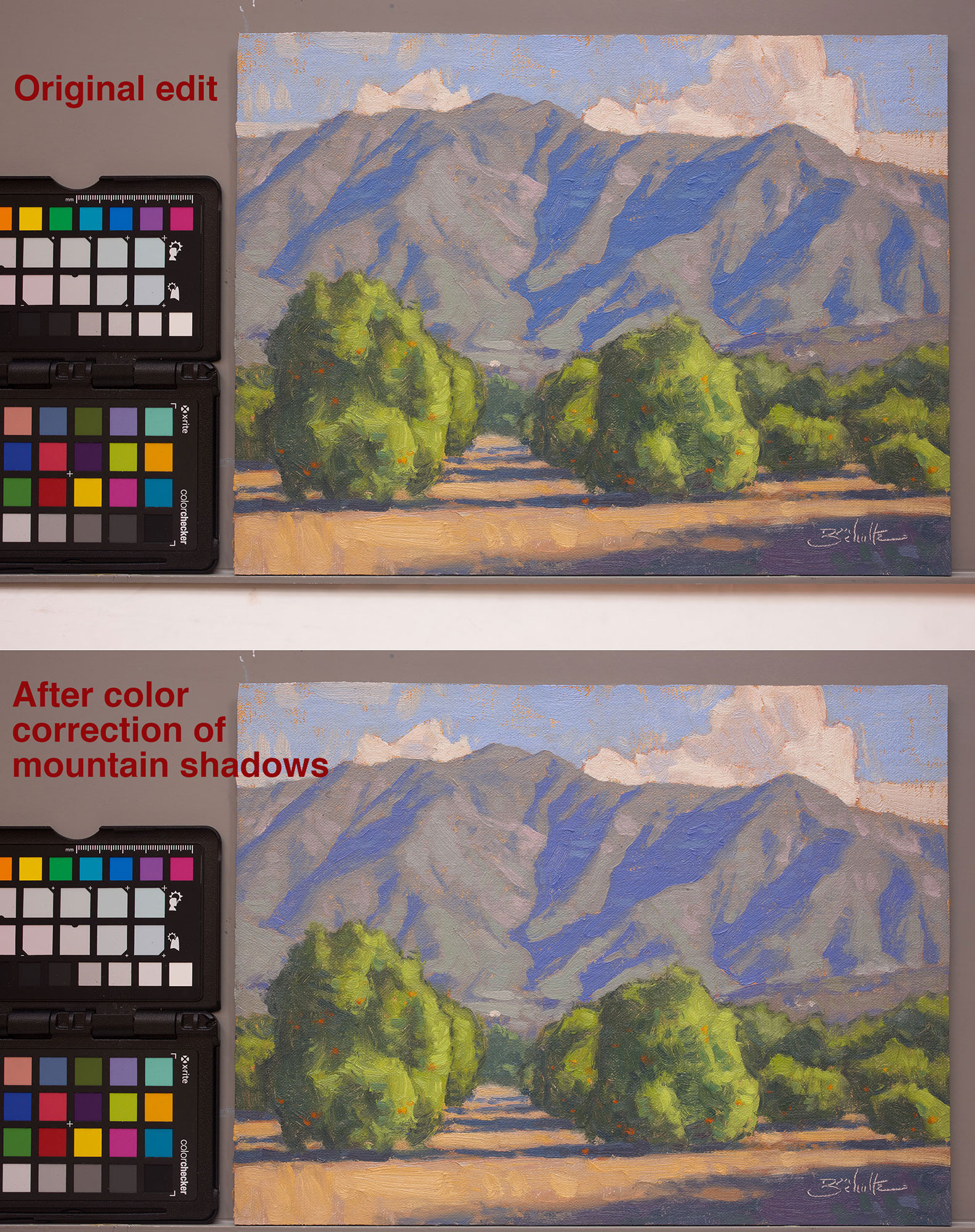

Hey, thanks in advance to anyone who may have thoughts on this. I upgraded to the Canon EOS R in December of 2018. As an oil painter, I use it for taking photos of my finished paintings. I have a system dialed in for doing my best to capture as accurate colors as possible for each painting.
However, I’m finding some issues with the blue spectrum of colors in my artwork photos. The camera seems to be excellent with matching most of the colors in my paintings without much post-editing in Camera Raw and Photoshop. But the blues always seem to lean too much toward cyan. So I’m having to painstakingly select just the blue areas in my paintings to make specific adjustments to those blue areas (usually pushing them toward purple to match the colors in the painting).
Please see the photo at the following link.
https://www.danschultzfineart.com/w.../06/280196F4-5C52-4EAA-8AB8-E601E8CFE31E.jpeg

To me, the "original" looks better but I have not seen the original painting, of course.

Thank you -- my next step is to explore the color profiles in more depth to see if I can pinpoint anything. I do have a custom profile I set up for my camera using the Color Checker Passport software.
I suspect the lighting is the issue though, so I'm looking into alternatives for that too....
