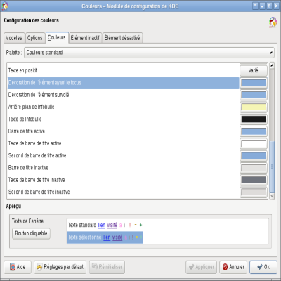

In KDE Neon and Manjaro KDE it was easy to change the active title bar from dark gray to teal. No such luck in Manjaro Xfce; maybe it's a CSS file edit. KDE Neon does not have a Terminal in the default applications (weird!) but it's probably easy to add. Heck even Windows 10 has CMD and PowerShell in the menus.
Ahhh, how did you do that (in Manjaro)?
Very few themes in Manjaro (Cinnamon or KDE) differentiate the active and inactive window appearance. Breeze is one of the few so thanks Austinian for that tip.
I didn't know that. I too require a highlighted active title bar; guess I just got lucky with KDE choices.

Changing the color of the active title was a breeze with Breeze :-) I just went into System Settings | Colors.
Better still, I found a KDE color scheme based on Clearlooks (an old classic that I like) and imported that:

You asked how I got colored active title bar in KDE, but I guess Austinian answered? It was very intuitive... edit Theme, set color... can't recall the full details.
