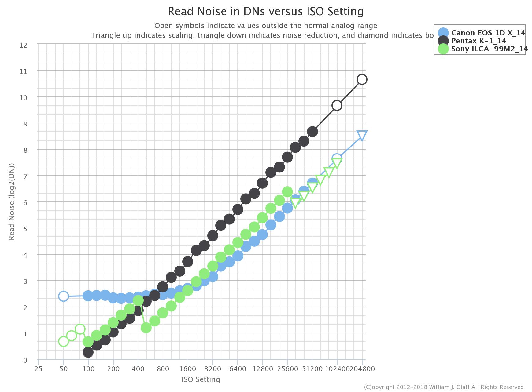

Suppose one is interested in deep shadow noise, where camera read noise dominates. Here is how 3 different cameras behave:
http://www.photonstophotos.net/Charts/RN_ADU.htm#Canon%20EOS%201D%20X_14,Pentax%20K-1_14,Sony%20ILCA-99M2_14
The Pentax K1 has low read noise which is near ISO-invariant, so that the output noise increases steadily with ISO setting.
The Canon 1DX appears to have significant analogue noise between pre-amp and ADC, so that there is a plateau between ISO 50 and ISO 1000 where read noise is almost independent of ISO setting. Here one can trade depth of field against shutter speed with minimal impact on output read noise.
The Sony 99M2 shows a step drop in noise at ISO 400, presumably where the DR pix gain switches.
Each of these calls for a different mathematical description. Arguably, only the Pentax shows a monotonic increase of noise with ISO setting, implied by your statements.
