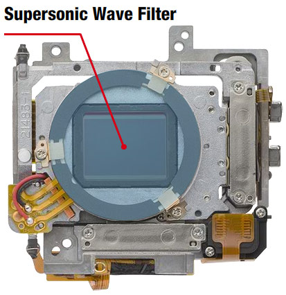

It's not user removable/replaceable by the owner, but it doesn't have to be. EVERY Olympus interchangeable lens camera and dSLR since the first FourThirds camera, the E-1 back in 2003, has such a thing called the SSWF (SuperSonic Wave Filter) which is a separate filter in front of the sensor sandwich that vibrates when you turn on the camera, shaking the dust off:
You can see it in action at the following link:
https://www.youtube.com/watch?v=67zQ7lYyl38
I have NEVER needed to clean the sensor on any Olympus (or Panasonic) FourThirds or Micro FourThirds camera I have ever owned, including ones from more than 10 years ago!
