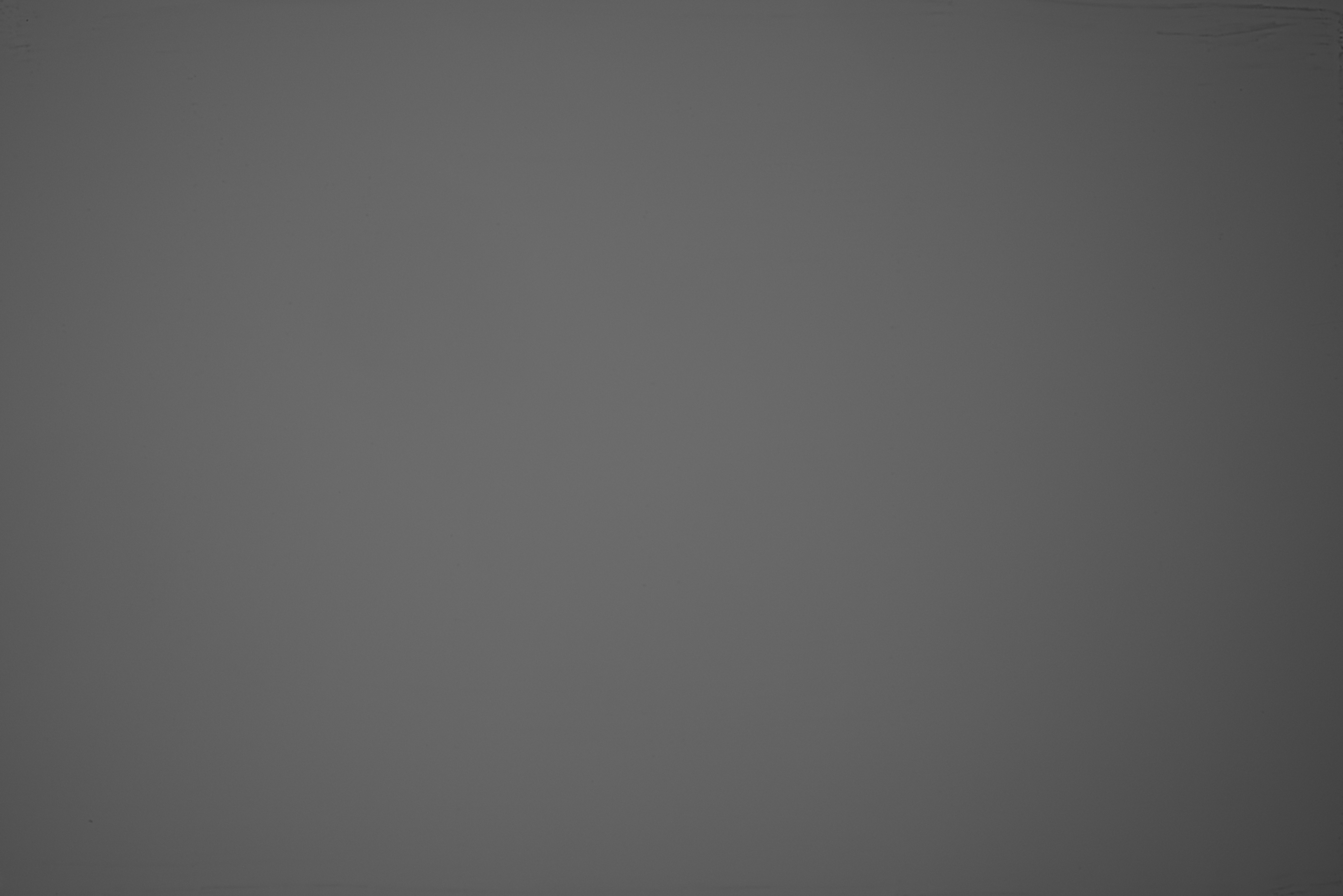

Thank you both for your tips. I've reduced the quantity of Eclipse fluid. But I'm still not there yet. Attached is an image of the top right corner (at 100%):
Edited to add: and here's the full size jpeg that I took that crop from (click 'original size'):
As you can see, most of the sensor is now dust free, but there's a lot of mess around the edges.

Look like the sensor still wet when the image as taken - make sure you use the type of cleaning fluid that leaves no residue after drying off

Yes, it needed wet cleaning. The instructions for my swabs recommend using a dry swab first, and only proceeding with a wet clean if marks remain. The dry swab did a great job, removing 95% of the dust. But two pieces of 'dust' left long smudges - I reckon one was an oil spot, the other maybe pollen. So a wet clean was necessary.
