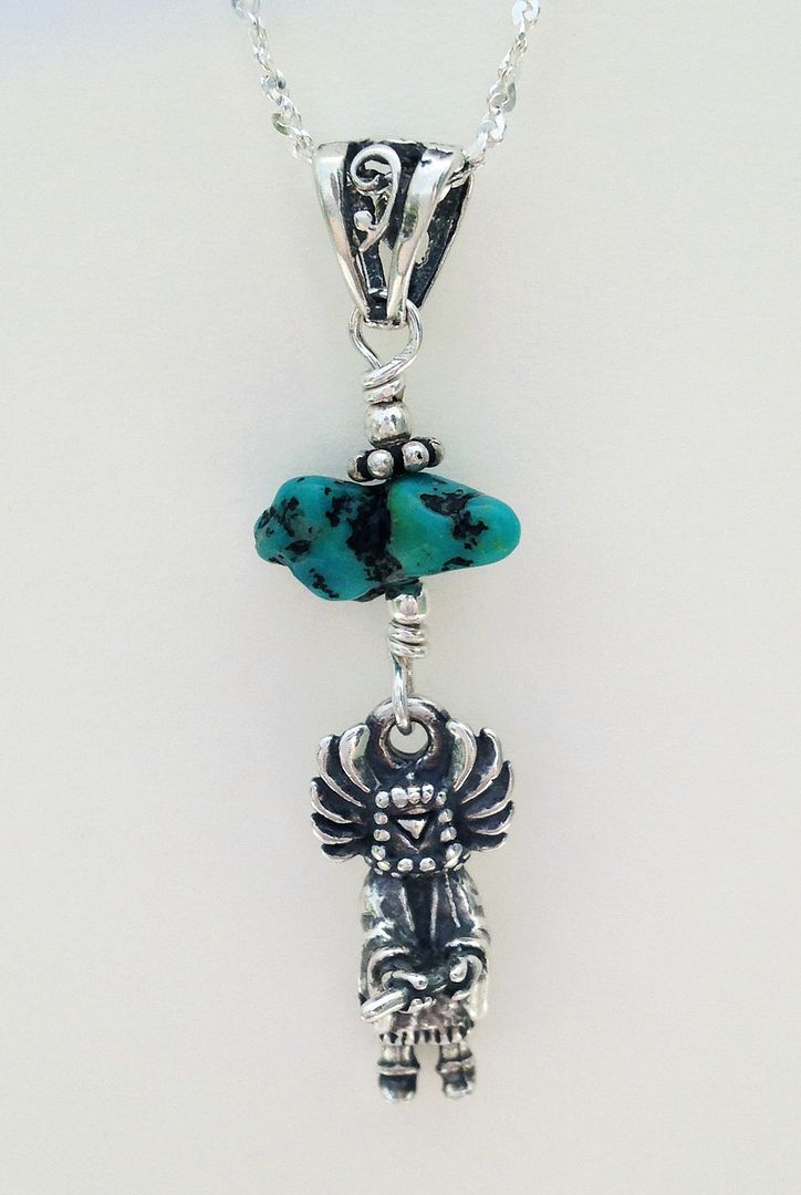

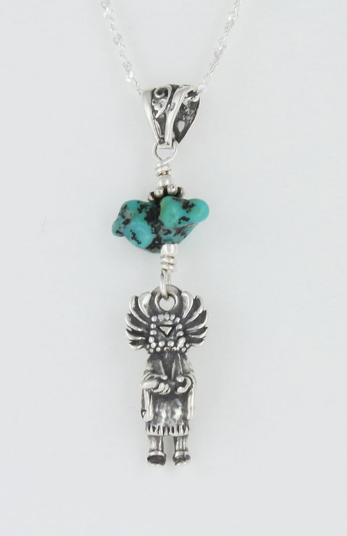

Ok, here are some photos.
This one was taken with my Canon under florescent lighted photo box.
This one was taken with my iPhone under sunlight in a photo box. The camera can not take photos of any quality under florescent lighting... Would be great if it did! -problem solved, LOL!
You can see a difference in sharpness. The sharpness does get a little better if I put the AEB on normal, but the picture is so dark then that I can't adjust it to look decent for webpage.
http://i1096.photobucket.com/albums/g336/ChrisEd112/photoshop/canon.jpg
http://i1096.photobucket.com/albums/g336/ChrisEd112/photoshop/425a32.jpg
it's all about the lighting and lens and to some extent proper settings
fluorescent lighting cycles, that's why product lighting usually requires a flash or strobes
that was shot at 1/20 at f16 - good recipe for unsharp pics !
get a 1:1 macro lens and ask questions in a lighting/flash forum
this is with a seven (7) year old canon digital rebel xsi with 10 year old film lens Tamron 90mm macro len and just window lighting
