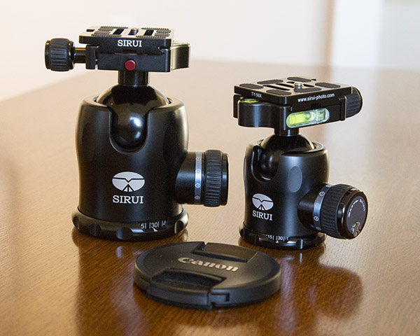

I recently purchased a K-30 ballhead and I really like it. It is beautifully made. I do some macro photography and needed a ball head that doesn't 'sag' as you lock it in place. Even a small amount of sagging can alter the composition in the viewfinder at high magnifications. The Sirui hardly moves at all during or after locking and I have a large telephoto macro lens that is 1.6Kg plus the weight of the camera. I thought about getting the K-40 but it is a bit of a jump in terms of weight and I just felt that the K-30 hit a sweet spot for weight and performance.
The Sirui's also come with the clamp and arca swiss compatible plate. They are an incredible bargain competing directly on performance with ball heads several times their price.
I have the Sirui K-30X for over a month and love it. However there is a slight ergonomic flaw to it in my mind. The notch for portrait pictures is in the wrong location. it should be on the opposite side of the lock knob. That way when you put your camera to the left you can still have your shutter buttons on the top and then the lock knob is still ergonomically accessible on the right side. But where the notch is when shooting in portrait the lock knob will be in front of you.
The build quality of the ball head is amazing. And i've done many long term exposure pictures for up to 2 hours and have experienced virtually zero sag.

I don't think you could go wrong with either one really. Although I must say that the engineering and machining on the Sirui is absolutely incredible. It's been so long since I've handled a Feisol I can't properly compare them. I do remember the Feisol seeming like an old Markins, and I'll bet that they're quite comparable.
Between the K-20X and the K-30X, I'd recommend the 30. I have the K-20X and the K-40X. The 20 will hold almost anything I've got fairly comfortably, but it can strain a bit when actually moving and adjusting. My 2 heaviest lenses are Sigma 70-200/2.8 OS (3 lbs.) and Tamron 150-600 (7 lbs) and I just won't put the Tamron on it. If I had to own only one ball head, I'd go for the 30.
The difference between the Sirui and Feisol is that the K series Sirui use a single knob for lock and friction. This can be fantastic when the ball head isn't stressed in the least. For instance, I can have my Tamron on the 40, and have enough friction dialed in that I can move the camera around, but not have to lock it down once in position - even at angles.
The Feisol is more old-school in that it has independent knobs for friction and locking. A lot of people prefer this solution - and I could see especially in a smaller ball head this would be the way to go. So I think really this is your hardest decision - both brands should give you many years of excellent use.
