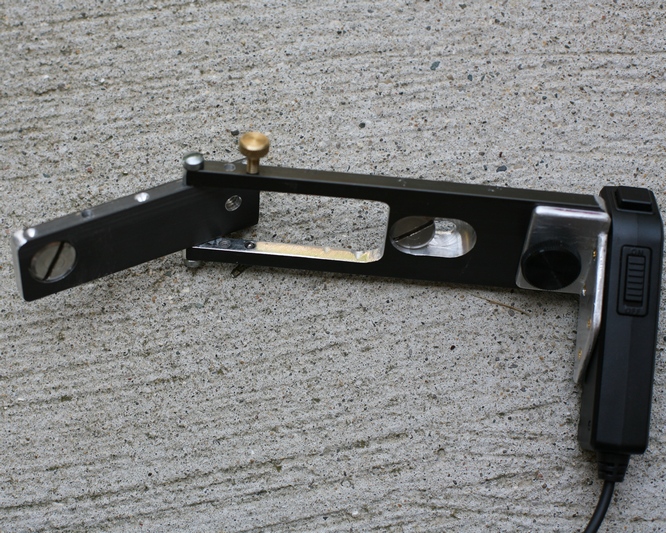

For wider stereo base, I have a pair of Canon G7's which I can use in portrait or landscape mode with my flipbracket, or separate much wider for hyperstereo.
Do you know the brand of your flip bracket, I do not find suitable ones on the web?
Thanks a lot!
I manufactured it myself. I designed it specifically for the Canon G7's so it probably would not work for other models.
Here is a picture of the bracket without the cameras mounted:
