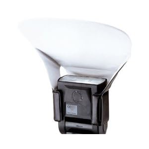

  • When I do flash I use either the build in flash, just for fill flash, or an external flash but that one only bouced (have a bounce-thing like this:
