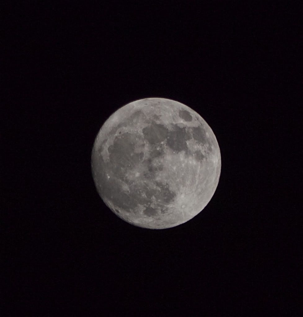

Here's one I took yesterday night.
G2 + 45-200mm Hand Held.
Here's the EXIF Data:
Hope it helps...
File name: hhhh.jpg
File size: 709296 bytes (1019x1068, 5.2bpp, 5x)
EXIF Summary: 1/1600s f/5.6 ISO800 200mm

G2 from several nights ago shot by son. don't think he did anything special besides the manual focus.
Thank you both for the respond. Both shots are fantastic. Now, I am completely confused. I assume you set you camera to M mode. I thought I have to slow down the shutter speed at night. I didn't only want to shoot the moon like you both did, I tried to include the landscape. I obviously don't have a clue.
