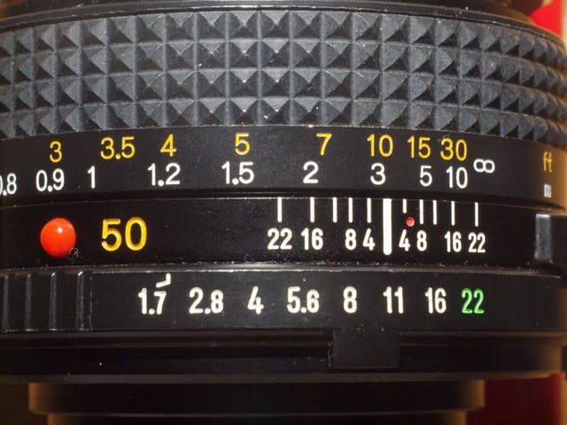

My assumption these many years is that the term "stop" came from the aperture ring having clicks on it.
Normally you'd be looking through the camera's viewfinder and turning the aperture ring to adjust exposure. f2.8, f4, f5.6...as you turn the ring, it sort of clicks (stops) on those. That gave you a tactile way of knowing how many times you halved or doubled the exposure. Of course, you could stop the camera halfway between two of the clicks---say, a half stop or a third of a stop.
Same with the old shutter speed dials, but they were usually top mounted. 1 stop or click on the aperture was the same as 1 stop or click on the shutter speed. The ISO usually had a different system so you couldn't accidentally change it, since the sensitivity of the film couldn't be changed in mid roll, but it has full stops as well, doubling or halving.

A "stop" is a is a halving or doubling of light. This can be achieved with the aperture, shutter speed, or ISO (though people dont usually talk about ISO stops).
For aperture, the standard f-stop (different "stop" here) values are:
1 1.4 2 2.8 4 5.6 8 11 16 22 (a sequence of the powers of the square root of 2, if you're curious) and as the number gets bigger the opening gets smaller and lets in more light
Thus, since f2 is one stop faster than f2.8 it will let in twice as much light. f8 is two stops slower than f4 it lets in 25% as much light.
Likewise, with shutter speed, at 1/200 the shutter is open for half as long as 1/100 and so lets in half as much light so would be considered one stop different.
When people talk about "stopping down" a lens they are simply talking about moving the lens to a slower fstop (higher f number) and this is usually because lenses are sharper a few stops away from wide open (lowest possible f number)

"Stops" are units of exposure. For example,, when you double the ISO you add a stop. When you half the ISO you subtract a stop. Likewise when you half the shutter speed you loose a stop and when you double it you gain a stop.
With lens aperture you gain a stop by making the aperture wider by a certain amount and loose a stop when you make the aperture smaller by a certain amount.
The term "stop down" is only applied to aperture. Typically lenses are not at their best ( with exceptions ) when wide open ( at their widest aperture ). You would "stop down" to gain sharpness. Sometimes you might have a lens that has poor contrast when wide open and you might see someone say it improves when stopped down.
Aperture whole stops are easy to calculate.
Start with the numbers 1 and 1.4
Double them. - 2 and 2.8
Double the results - 4 and 5.6
Double those results - 8 and 11 ( roughly )
Double those results - 16 and 22
The sequence f1, f1.4, f2, f2.8, f4, f5.6, f8, f11, f16, f22 is the sequence in whole stops from widest aperture to narrowest.
You can have aperture values apart from these, but this is the reference sequence.
Likewise you have ISO values a stop apart 100, 200, 400, 800, 1600 - doubling each time.

The "stop" was a metal plate with a hole in it inserted into the lens through a slot in the side. It was called a "stop" for no other reason than because it "stopped" some of the light getting through.
Back then a series of different sized plate holes were used to allow different amounts of light into the camera during the exposure. The spare metal "stops" were kept in a little leather pouch that lived with the lens.
These days we use continuously variable iris diaphragms made of overlapping metal leaves. They act like the variable iris in your eye.
The act of choosing a smaller aperture called "stopping down" the lens.
