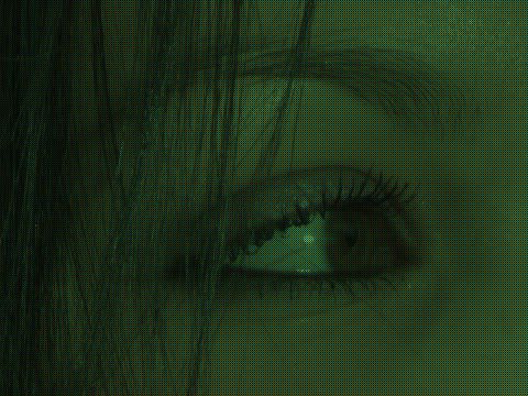

Is it possible to get the image as it came out of the sensor into a TIF file? It would look gray scale but the Bayer pattern should be very apparent.
Thanks,
RON C
Sure, it's possible, Ron:
My post to an interesting thread some time ago: http://forums.dpreview.com/forums/readflat.asp?forum=1036&message=28541148&q=gordonbgood+caer&qf=m
Excerpt: Here is a 100% zoom crop of a Colour Filter Array map, processed with completely flat natural tone response curves (a monitor type tone response curve and not linear or the image would be almost too dark to see) and the native colour matrix from the K10D camera produced DNG files but absolutely no Bayer demosiacing. I forgot that the images would still be a bit dark and dull due to losing about 1.5 stops of brightness as there is only one R, G, or B component for any given pixel site. Notice how sharp it is without any sharpness added at all (ie. sharpening is mostly required due to the interpolation process):
And another excerpt from a later post in the thread: In order to avoid the confusion caused by the colour tint and in order to better show how sharp the unsharpened non spacially interpolated raw image really is, I produced the following black and white version where the normally zeroed colour values in the Colour Filter Array (CFA) are set to the same value as the one colour value after colour correction and tone response curve scaling. Again, note how sharp this is. This is truly the maximum resolution that a Bayer sensor can output:
However, note that these images only look this good when viewed at 100% zooms, as they don't upsize and downsize well since the Bayer pattern is still buried in the textures. In this case, the Bayer demosiacing is being done by your eyes. To see this, use the Zoom In controls above the images to zoom up to 400%.
Regards, GordonBGood
