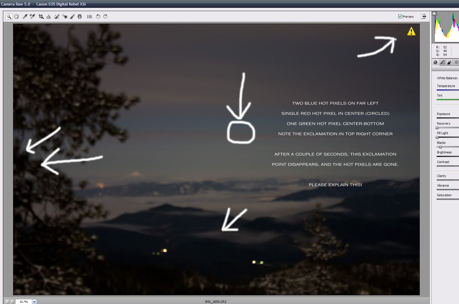

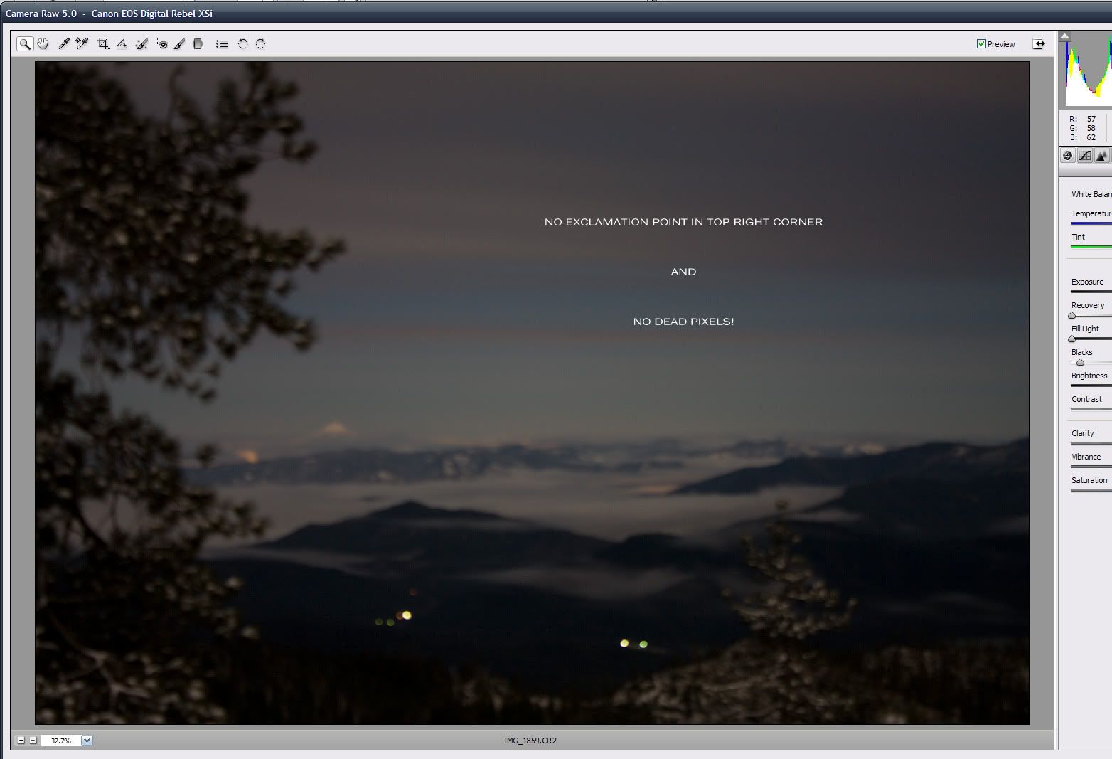

But something I noticed today, since I have my larger monitor (and hence, Camera RAW is full-screen now as well) - the hot pixels ARE THERE when I FIRST LOAD THE RAW FILE IN ADOBE CAMERA RAW, but after about two seconds, the "!" in the top right corner goes away, and so do all the hot pixels.

So, upon loading another RAW full screen, I saw the hot pixels show up, but there was that exclamation point in the top right corner of ACR. When that disappears, so do all the hot pixels!

Okay good, because that means I'm not just seeing things!
I was successful in getting screen shots to prove my (our?) points.
Somebody with knowledge, please advise! Is there a way to do this for JPG's as well (in Photoshop CS4). I would love to know this secret, would GREATLY help me out in doing batches!!!!

AFTER

as well as some other RAW programs, have automatic hot pixel elimination built into them. It's been around for a long, long time. Nifty feature actually, I just wish DPP did the same. ;)

Ahh, see this is what was intriguing me.
I had the same issue - it never used to do this, but now it does.
I wonder if it "learns" of these hot pixels and identifies hot spots that spread through all shots taken with the same camera number, or something in the EXIF. Maybe it has something that identifies that camera, and it learns of the hot pixels for future use... and removes them without asking.
I kind of like it. Thankfully I use ACR. :-)
And yes, I have tried loading a JPG into ACR - and it didn't work. A shame, really. But at least I can simply batch everything in RAW, set the picture style, maybe a bump in sharpness, select all my RAWs and just batch them to JPG's. It worked on a run of 10, in removing the hot pixels.
