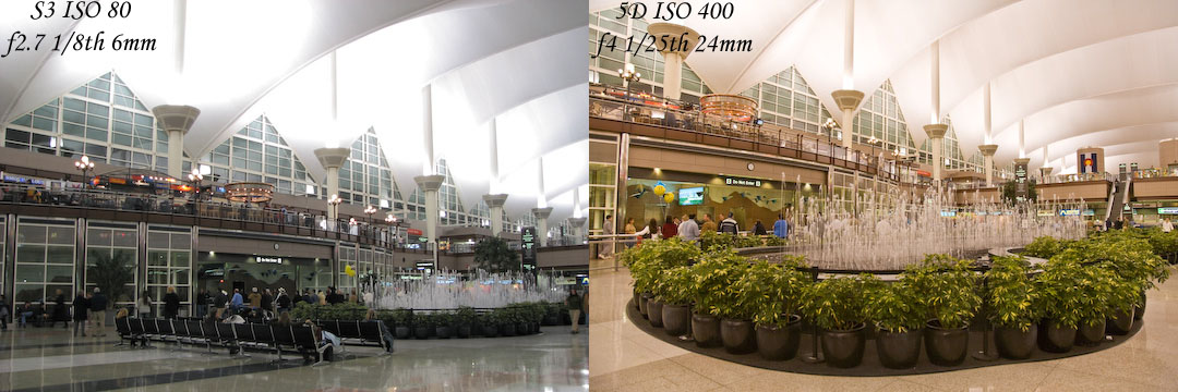

Dynamic range is the biggest ones. Shooting raw on a camera with significant raw headroom can mean the difference between wide swaths of pure white, or colored visible detail in those areas. And that is visible at any size.
The below image, while not a raw versus JPEG comparison, is a comparison of small dynamic range (on the left) to large dynamic range (on the right). Note the ceiling for an example of what I just described.

As for your image (looks like the Denver airport). This is very like taking a landscape with bright white clouds. If I was taking it with my Panasonic FZ50 or G10 I would take the image after having set the exposure by considering the histogram. I would then look at the review image for blinking highlights. If any, I would reduce the exposure and repeat until the blinking highlights are no more. That, for me, would be the perfect image (expose to the right, as they say). In a few cases the dark areas, or even the entire image, will be too dark. I bring them up with "lighten darks" or by moving the center slider in Photoshop. I do not tolerate either blown highlights or big black areas in any of my landscape prints (except for small areas of glare on rippling water). They would sell, but I am a perfectionist and do not want to "stick" anyone with a less than perfect print.
This sounds like a lot of effort, but it is just a matter of seconds. And the vast majority of landscape images do not present the potential to have blown highlights. It is only a few (bright clouds) that take this level of care.
Looking at the posted images on Steves for the G10 (the firehouse images), I see no advantage for his RAW image over his JPEG. Both are equally sharp and detailed in all areas. Look at the twigs. Look at the bricks. The RAW was taken on a sunny day giving it every advantage over the cloudy day JPEG image. And yet the JPEG cloudy day images matches the RAW in every respect.
Just my opinion.
The trouble is, the plants in front of the fountain are driven almost to black, whereas they are actually green. Exposing darker to preserve the ceiling would make that problem worse. Attempting to boost the darks in post processing just made the plants noisy, not green, and not brighter or more detailed. So that's a lack of dynamic range issue - the brights are too bright and the darks are too dark, both at the same time. The only solutions are a wider dynamic range camera and processing system, or a multiple image blend which is a painful solution when there are moving subjects in the scene.
scene.
Lee Jay is correct. Using a -EV does not increase DR. Most DSLR jpegs have about 8.5EV in DR. Most Raw files from the same DSLR has an increase of anything up to 1-2 stops of DR to give about 10EV. These figures really do not change. You may be able to protect your highlights using EV on the camera, but you push everything else towards the shadow areas (underexposing the shadow areas). Depending on the scene and amount of EV applied, any dark tones that are not pure black (like dark reds/greens/purple ect)....will appear black because you are now underexposing them.
And if you have to "pull" them out in PP, you will also open up more noise in the shadows and still never quite get back that original colour. But if you have to pull out those shadows and use post processing, you are defeating the purpose of using jpeg in the first place (no PP) and you might have shot raw.
Also with raw, you do not have to nail the exposure perfectly which saves time. It the highlight tools is only blinking slightly in areas, then you can move on to you next shot knowing that you can recover up to 1EV of highlight data overexposed on a DSLR. With Jpegs you have to shoot again, check again, and if you didn't get it right the second time, then go through the process for a third time. And I bet you have experienced doing that from time to time having to make 3 exposures for the one shot, because I have.

Dynamic range is easily increased by decreasing the contrast setting of the camera before taking the image. Then in Photoshop move the left and right sliders in Levels.
The S3 image I showed was with contrast -2, sharpening -2, saturation -1 and green -1. I don't think there's any more dynamic range to be extracted from a JPEG from that camera.

but if I had to choose the better of the two than it would be the first one made with the S3.
described.
Your correct.......it does increase the DR of a jpeg. But you haven't your listening ears on. What me and Lee jay are saying (from experience)..... is that when you back off all those settings in jpeg, a raw file has still more dynamic range....period. It might not be as apparent in a P&S, but most overwhelmingly with a DSLR. Only once ever have I found that this was not the case in a DSLR. And that was with the exceptional DR king....the S5pro.
Obviously you have not experienced this. You should try it, especially with a DSLR. Or if you aren't conviced by me or LeeJay.......have a good read on this website blog about it. Here's the link and here's the proof by professional reviewers:
http://blog.dpreview.com/editorial/2009/01/raw-headroom.html
