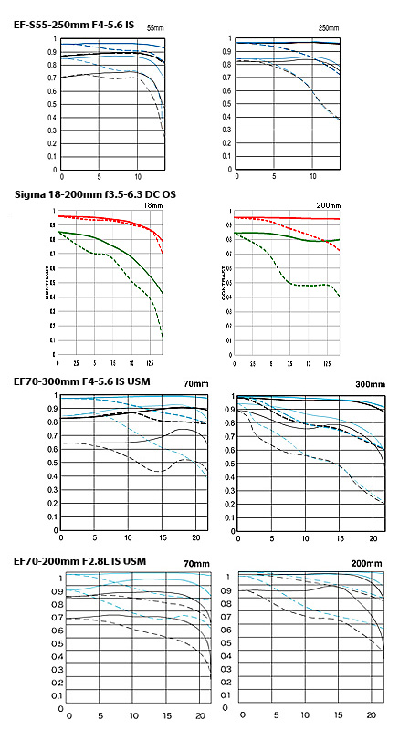

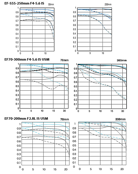

I rescaled the MTFs to make them more comparable.
While I do not expect wonders, it sure looks promising. Having used both the two others, I know their pros and cons. Still; coupled with a 400D/XTi this should make for a great lightweight kit, which often is the most important thing - to me... So - I just ordered the 55-250, they expect delivery on Oct 3rd, locally...

I don't know to read MTF charts, but how does the 55-250's chart compare with the Sigma 18-200 OS's?
Also, are MTFs a reasonable representation of how the lens works in real life, or are they simply theoretical models?
See below - similar, but I think the 55-250 has the edge...
They inform you about resolving power and contrast, but not much about i.e. colors, and nothing about focus speed and handling.

Here's the 70-200 f4L IS for comparison:
at 70mm:
at 200mm:
It is very hard to compare it to the sigma 18-200 because the chart we are looking at is the 18mm vs the 55mm. It's too far off and it would be unfair to match them. However, the sigma seems to have a decent if not good mtf on 18. It's not bad at all.
At 200mm and 250mm, the 55-250 beats the sigma, not just by a little. Yes, there is a 50mm difference but that is not as big now at the long end. Plus the sigma is f6.3 while the 55-250 is f5.6, so stop it down a little and it adds up a tad to the better performance. But regardless, the sigma does not hold up at 200mm . Canon is much better. Again, in fairness, the sigma is an 18-200 lens, and there are a lot of compromises there.
Now, for the interesting part.
As you can see the ef-s 55-250 IS is better compared to the 70-200 f4L IS. Remember to read the 70-200 only up to the 15mm mark as the ef-s is for crop cameras. The L lens beats the ef-s lens at 200/250mm in both contrast and sharpness. But the ef-s holds its own and will be fairly sharp, especially at the center where they are very close.
At the wide end, the comparison becomes interesting. We don't have a 70mm take on the ef-s lens, but if we assume that it is the same (likely it is the same, THOUGH I suspect there the mtf will be slightly better at 70 for the efs) the ef-s lens actually is better than the 70-200L lens! Yes, the L is slightly higher, but it's M line falls of and parts off with the S line. The ef-s lens, however, holds it there and therefore is actually sharper! At f8, the L lens pulls in even with the ef-s, but of course, you will likely be using these lenses wide open or just slightly stopped down due to the need to maintain shutter speed.
As far as contrast goes, the L is slightly ahead, but it is negligible in real world situations. In fact, the ef-s is slightly better in contrast at the edges at f8. But as I said, it is negligible in real world situations.
I suspect that if you use the 55-250 up to around 180mm only, the MTF will be very close to the 70-200L lens. Actually, the ef-s is beaten only at the corners, so you can safely go to 200-250mm if the corners/edges isn't that much of a problem to you. In tight portraits, most likely it won't. But if it is, just remind yourself to keep your shots at around 150-180mm max. Think of the lens as a 55-150/180 lens and the rest is bonus. It keeps your wide open aperture also within f4.5-5.0 most likely at those ranges.
I will no longer compare the 55-250 with the 70-300 IS because, the ef-s is really much better than the 70-300 IS as the charts will show.
