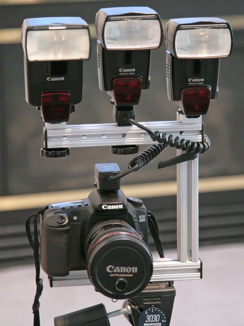

Pics with the ultimate flash diffuser!
Did you have to do anything tricky to ensure the lower flash
triggered properly, or did the infrared reflect off the subjects?
Well, typically Im only shooting 3 feet or so from my subject so there is plenty of light bouncing around to trigger the slave. Even if the slave doesn't go off, the exposure is still correct, this makes it a bit hard to know when the batteries are low. I think the signal from the master comes from the actual flash head, not the IR LEDs.

...and so original. At leat I haven't seen it until now, and I've
done lots of flash modifications on my own.
I love to tinker, but this idea is so great because of its simplicity.
It looks like a great idea in theory (two flash canceling out the
shadow), and you proved that it is also a great idea in practice.
Having skills and good looking people to show off your skills
doesn't hurt either ;-p
Congrats!!!

Which I modified into a flash bracket:
If you turn one of the side flashes up and the other to the side, leaving the center one direct, you can have a hand-held studio using them for a fill, key and side light, controlling the ratios with wireless ETTL.

Fantastic work!
Did you use direct flash or bounce on the
top flash (for the indoor photos)?
Was the stofen primarily used on the
bottom flash?
Would there be any benefit in using
a stofen on both flash units?

I had tried using a stofen on both, but I loose so much efficiency that I can't shoot as fast as I'd like. Usually there is nothing above me to bounce a flash, so a stofen on top doesn't do much good. The wide panel diffuser gives more uniform light. The flash on the bottom only goes to 28mm so the stofen makes the light not so focused with the fisheye. I have tried both flashes at 45 degrees, but dont' see a huge difference, Im usually shooting less than 3 feet from my subject, whatever light is bounced gets washed out by direct light.
awesome shots, and a very cool idea.
what kind of shutter speeds were you shooting at, since you had two flashes.
thx
Hi Eric,
Love the simplicity of your idea and the results really speak for themselves - awesome!
I'd be grateful if you could tell me where you picked up your aluminium block (brand/model) that you attached to your camera.
Thanks again for sharing.
Cheers
http://www.mintimage.com
It came off of my umbrella stand kit from b&h, you could probably buy just the adjustable bracket that holds the umbrella and flash to get the aluminum piece.
