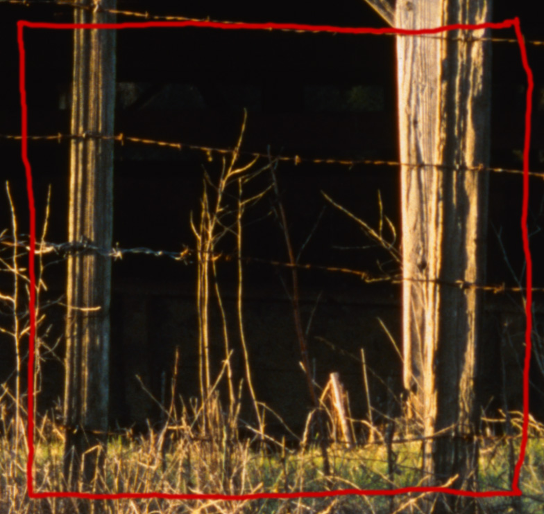

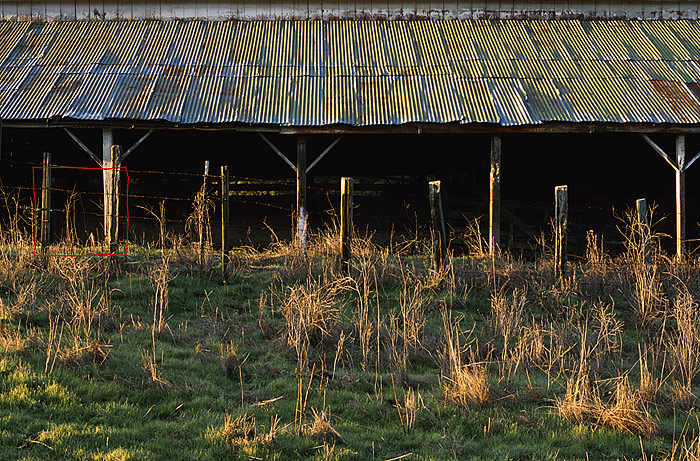

Here's some actual pixels 4000ppi scanner output (Fuji Provia 100F, exposed and processed for ISO 200):
http://www.blackmallard.com/film/section.jpg
Here's the same thing with a bit of Photoshop sharpening for screen:
(Amount 350%, Radius 0.3, Threshold 0)
http://www.blackmallard.com/film/sharpnd.jpg
From this photograph:
http://www.blackmallard.com/film/frame.jpg
Hell, smoking a 6 megapixel digital SLR image at 12" x 18" print size is so not a sweat, it ain't even funny. Though, I admit you do have to know what you're doing with both (film and digital) machines.
