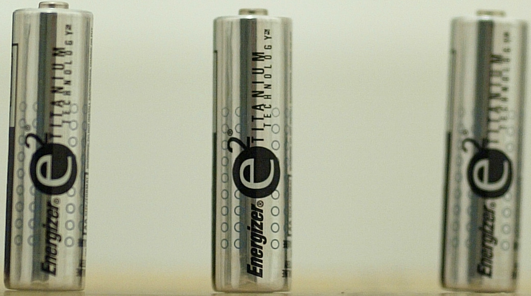

d10 front focuses PROOF!!
Where it focused was JUST outside of the AF sensor box. I'm of the belief that the actual AF sensor is actually larger than the box.
So, lay down some masking tape on the bottom edge of that ruler, except around the number you're focusing on.
Then use the top scale (well outside the focus point) and the one number that shows below (where you focused) to see if it still front-focuses.
Canon SLR's have a predisposition to focus on the closest thing in the AF sensor area that has good contrast.
This may be what's causing the problem.
Either do that, or a test like this:

i have superimposed the focus screne as requested
http://www.pbase.com/image/15500552

Something I found when doing my focus test was that sometimes my hands moved enough that the focus pont was not over what I focused on. The Canon software doesn't reflect the foucus point accurately if you lock on focus and recompose the shot.
I ran my test seven times and one time I had front focusing and the above is what happened. My hands moved. I'm too lazy to setup my tripod. It is packed away for a trip.

Was the camera mounted on a tripod and, if not, you're absolutely certain you didn't move. I know it's hard for me to hold absolutely still and with the wide aperture and shallow DOF you're using, just a little movement can make a difference.
You would think if they were going to insult me they would at least wish me happy birthday. BTW did you check out my screen capture. I ran that test inside the house and nailed it six out of seven times. The one bad one was my fault.
