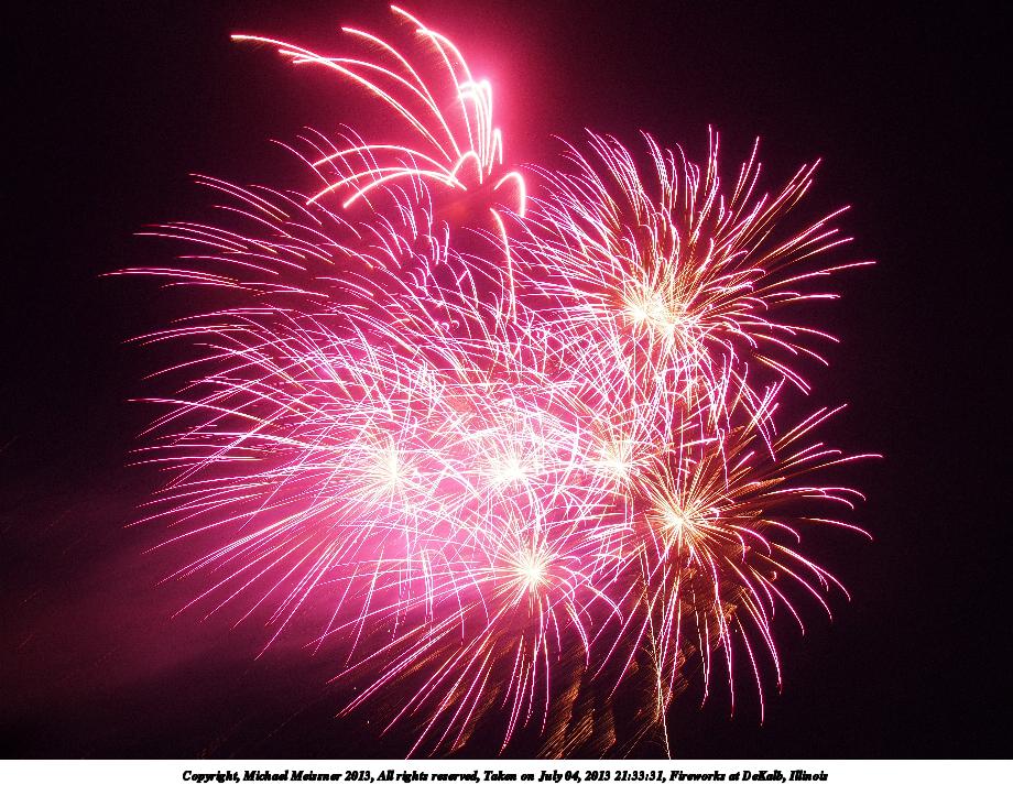

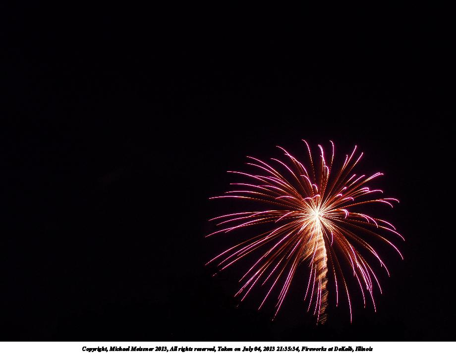

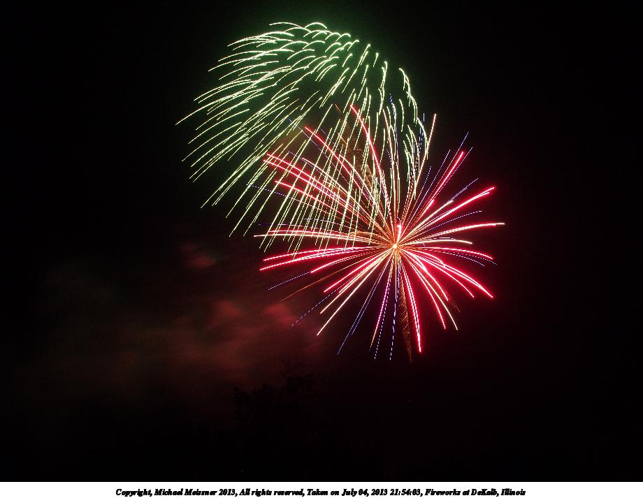

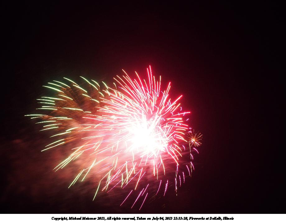

Here are some fireworks photos I took in 2013 when I was visiting my father in DeKalb Illinois, using an E-PM2 with the 14-150mm lens stopped down to f/8.  I used a shutter release cable (RM-UC1 clone) so that I could watch the fireworks with my eyes and enjoy it, and just every so often hold the shutter down (time was set to bulb mode). Most of the times were around 2-3 seconds:
DeKalb, Illinois fireworks, f/8, 1/2 second
DeKalb, Illinois fireworks, f/8, 2.5 seconds
DeKalb, Illinois, f/8, 2.1 seconds
DeKalb, Illinois, f/8, 1.3 seconds
