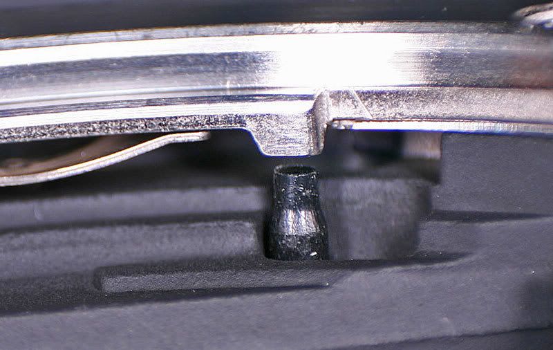

Roonal_Z Contributing Member • Posts: 559
Error 01 - I was able to replicate
There is a switch inside the camera at about the 10 O'clock position
What I think may be the problem is that your adapter is contacting this switch and moving it to the right and thus the camera is turn "looking" to communicate with a lens but can't therefore an error code.
I was able to replicate Error 01 by simply using the tip of the stylus for my touchpad to move the switch to the right and while holding it there pressing the shutter button - Error 01.
The picture above is of my 1DMkII but same for the 1DsMkII.
I had an issue some years back involving this switch where my chipped Nikon-EOS adapter did not move this switch therefore focus confirmation would not activate.
Someone/poster suggested at the time that this was a move by Canon to prevent 1D photographers from having focus confirmation if using non-canon lenses - said the later 1D's don't have this switch.
Good Day,
Roonal
OP creedens New Member • Posts: 3
Re: Error 01 - I was able to replicate
Roonal_Z You are a Genius ;] Good investigative work! ... It was this sliding pin causing an error ... After "shaving" a piece of the adapter i was able to make it work! . Thank You very much for your help .. You are a Hero!
Not seeing that switch inside 300D, 400D
Lemming51 wrote:
That switch has been a feature of the EF mount on, as far as I know, all EOS bodies from the beginning.
1D Mark II - same for 1Ds Mark II ___ Photo by Roonal Z
Not seeing this switch or any similar such switch inside the 300D and 400D bodies I have.
Quote from bobatkins.com
"On some EOS bodies there is a small microswitch in the lensmount which must not be tripped by any attached lens or lens adapter in order for the camera body to work. If an adapted manual focus lens trips this microswitch, the camera body them looks for a valid EF series lens to be attached. If it doesn't see the correct electrical connection the the camera body thinks there is an error condition and will not operate. I've never been able to find an official list of which bodies have this switch and which don't. The early 1D series bodies do, up to the 1D MkII. The 1D MkIII doesn't. I think the D30, D60 and 10D have it too (note that's the D30/D60 not the later 30D/60D). Some, possibly all, EOS film bodies have it. I know the EOS-3 does for example.
If you have one of the bodies with this microswitch and your adapted lens causes the camera to freeze you have to remove a small part of one of the bayonet flanges in order to avoid tripping the switch. Either that or do not lock the adapter completely in the EOS mount. If you don't fully rotate it so that it "clicks" into place it won't trip the switch. Of course the adapter is them not fully locked onto the camera, so you need to be careful not to accidentally allow the lens to part company with the camera!"
