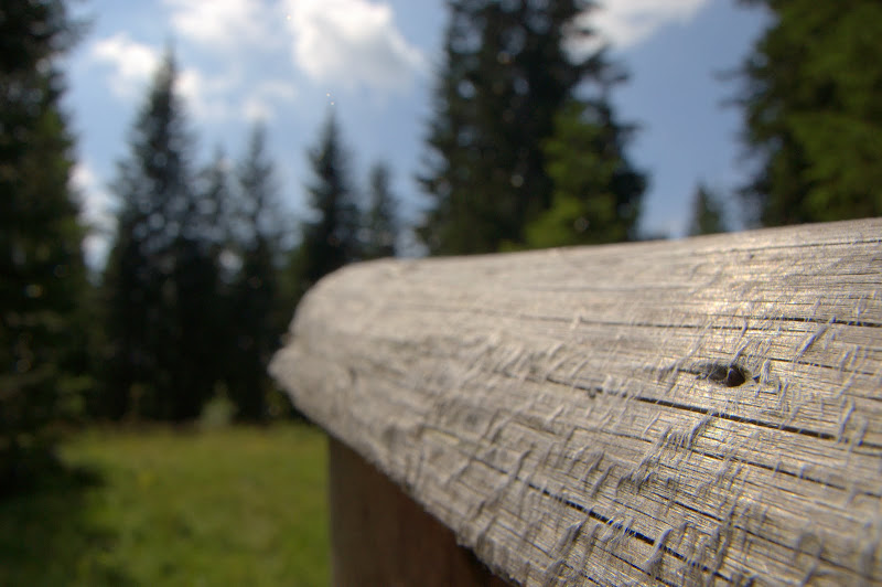

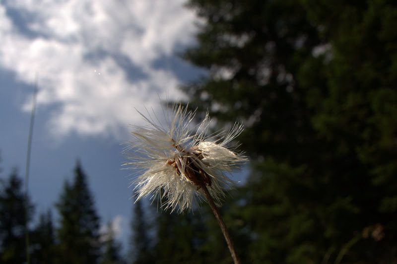

Some first-time samples... "Deepest" focus with the aperture almost closed, so bright light is required to get useful shutter time at base ISO. One should pay more attention to dust on the front element than I did And dust on your sensor may happen to be the only really sharp thing in your image at this aperture - so don't peep for sharpness cause there is none! You don't really need a sharp lens for deep-focus; resistance to flare and small physical size seem to be more field-relevant. Compared to a typical P&S: P&S requires less light for base ISO so is more handholdable; but modern Nikkors have much more DR at base ISO so fare better if playing with midday sunlight and pseudo-HDR (these are quick&dirty Picasa raw conversions).

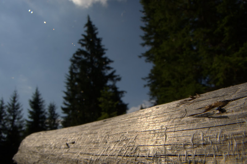

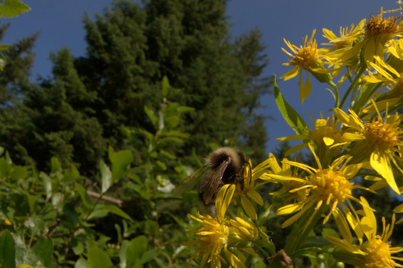

If you want to reduce diffraction blur or get more light in, you need to stop down the aperture a bit by fixing the aperture lever with a piece of cardboard or rubber. But the deep-focus effect decreases. Samples at unspecified intermediate aperture...
