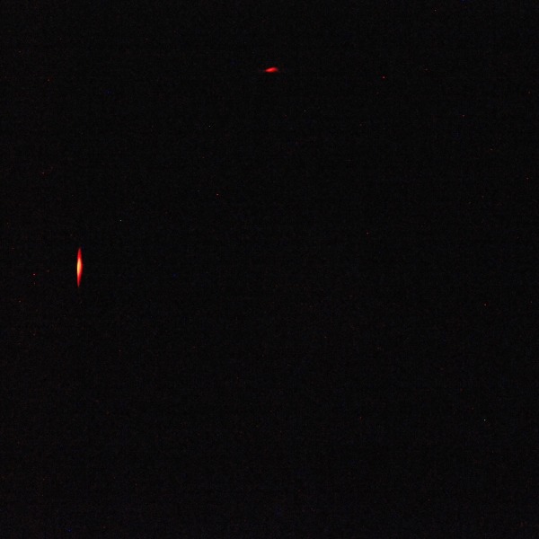

I carried out an investigation using my 70-200 VR. This lens produces a very distinct vertical red stripe on long-exposure images, approximately 7mm to the right of sensor center. I first ruled out reflections from potential sources within the camera body, by imaging the mirror box of my D300 over 30 minutes; the result was a completely black frame showing no IR sources.
Confirming the lens itself as the IR source was done by operating the lens on the camera, rotated away from its normal mounted position slightly so that it was de-powered, and observing that the IR pollution was eliminated.
The final step was to image the lens directly, to pinpoint the source. This was done by mounting the lens on an F100 film body, and setting up a second camera to look at the back of the lens through the open back of the F100 while it was operating. The second camera used was a D3 at 25,600 ISO, micro-Nikkor 105mm lens, at 10-second exposure time. By successive approximation of camera position and focus, I was finally able to obtain this image of the IR sources within the lens:
This is a crop, aligned so that the center of the crop is at the center of the subject lens. We see two IR sources (reflecting off of the diaphragm blades, I believe), one directly left of center, and a second dimmer source directly above center. The sources therefore lie on the horizontal and vertical axes, which of course are the axes along which the VR system moves the elements.
In any servo system such as the VR unit, there must be a means of position feedback to the control electronics. In various applications, we typically find potentiometers, strain gauges, LVDT's or RVDT's, and optical position sensors used for this. Apparently, the latter are employed in the VR unit. These consist of a light source, in this case an IR LED, and a phototransistor or transistor array which uses the light from the LED to read physical position. In the case of the 18-200 and 70-200 VR units, then, there must be a small amount of leakage from the IR LED which is finding its way via reflections, back to the camera's sensor.
Remedy
Unfortunately, this would be beyond simple at-home measures to remedy, as it would require disassembly of the lens, and installation of masking to control the stray IR.
The best solution, at least for now, may simply be awareness of the effect, so that the user can make informed choices regarding lenses for special applications.
within the lens:
Remedy

OP Marianne Oelund Veteran Member • Posts: 7,788
Yes, you can turn it off
SteveL54 wrote:
It's an easy workaround for the problem. I'm quite puzzled that Nikon
service didn't tell the OP from the first thread about turning the
lens AF switch to M/A.
If either switch (VR xor lens AF) is in the active position the IR
contamination seems to be the same.
Well, this is certainly embarrassing - I shouldn't believe every claim made in posts, without verifying them first. Max insisted that there was no combination of switch settings that would clear the problem. See http://forums.dpreview.com/forums/read.asp?forum=1039&message=26784890 , where he claimed to have been using the M/A switch "M" position.
Clearly, he wasn't, as this will turn off the IR source on both the 18-200 VR and 70-200 VR.
I did check the operation of the 18-200 on the D3, though, and the IR pattern is very interesting. No smooth gradients in the "bigger picture;" there are clear light and shadow areas on the sensor. If anyone's interested, I can post a sample.
Talk about much ado about nothing, though . . .
within the lens:
