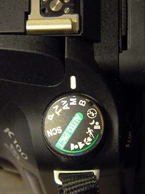

The second step is to set the camera to "M" (Manual) mode:

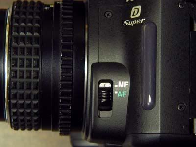

Next, set the focusing mode to "MF" (Manual Focus). There are some options regarding focusing that I'll mention below, but to get started "MF" will work best.

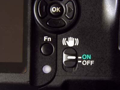

Turn on SR (Shake Reduction) by flipping the switch near the lower-right corner of the LCD:

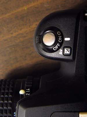

...and then turn on the camera:

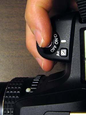

Half-press the shutter button to turn on the exposure meter:
You can tell the meter is on when the green digits below the viewfinder image light up (there's a menu option that controls how long the meter stays on - use if if the digits shut off too quickly for your taste). Because it's a manual lens, the camera has no idea what f/number you've set it to, so it will show "F(blank)" for the aperture.
