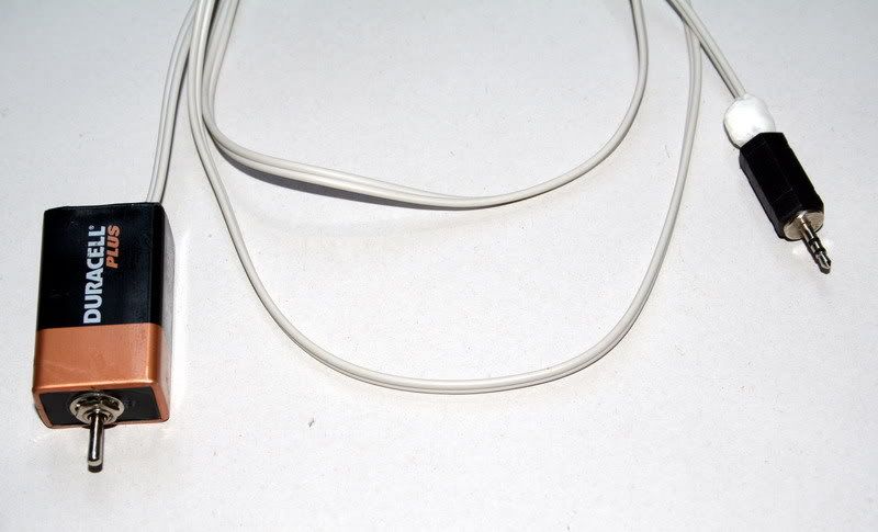

As far as I know you need the remote to keep the shutter open. Actually you might use a strong enough rubber band around the grip with something like a piece of cork between the band and the shutter release button. Theoretically the band might create the pressure for the cork to press on the shutter release. But I would'n do that, and I thing you wouldn't do it either - it could press too much and damage the button. And if you want a remote and can't get it right now check out my home made very cheap alternative. You may have the parts needed.
I emptied the inner parts of a 9V battery and installed the switch inside. Works flawlessly
It should fit the 400D right?

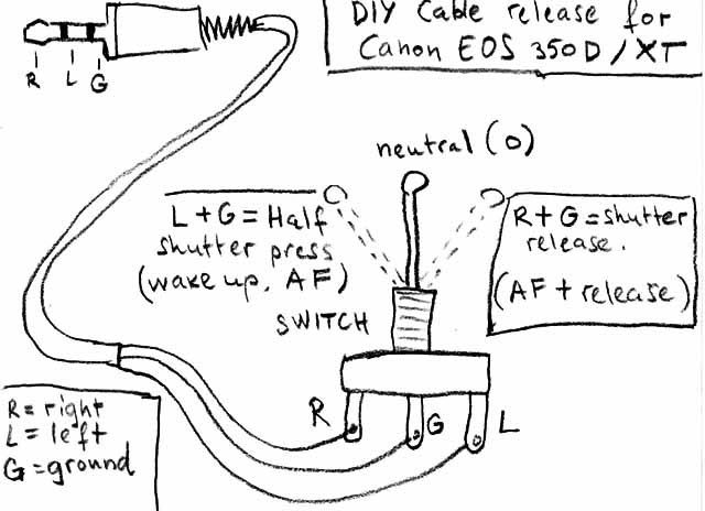

You haven't got the circuit quite right, though it will work on manual, and with manual focus just fine.
The actual remote would keep the AF circuit closed while closing the shutter switch -- that would prevent the AF from causing camera shake. When you close just the shutter circuit, the camera does try and activate the AF breifly before closing the shutter (unless you have it on MF, or if the AF is locked.)
Besides, for doing shots at the observatory, you might want to activate mirror lockup which needs a momentary contact on both circuits to activate. So, try this:
Connector (2.5mm mini stereo plug):
Tip Common
o~== ===[======]
Ring
Tip connected to common = shutter
ring connected to common = AF
T(Shutter) ------(switch)---------~
R(AF)--------------(switch)---------~
C--------(switch)--------------------+
The common line switch is normally in the closed (on) position.
When you want to take a long exposure photo, without mirror lockup,
first you activate the AF line, and when the camera is settled, activate the shutter line. Open (turn off) the shutter line to close the shutter.
If you activate mirror lockup in the custom functions menu, then you first activate the AF line, then the shutter line. This will lock the mirror up. Now, turn off the common line switch to ready the camera for the exposure. Turn it back on to release the shutter. You might want to use a NC push button instead of a switch on the common line, because it only takes a moment to lock the mirror up and settle before the exposure, however, an NC (normally closed) pushbutton may be hard to find -- most are NO (normally open).
The only other option you might like is an NO pushbutton in parrallel with the switch for the shutter. This will allow you to easily take a single exposure when the exposure time is something the camera can handle by itself.

Yes you are right, the camera does want to focus just before shutter. Actually it has never caused bad photos, but since you mentioned it I think I found the workaround - just activate the mirror lock up in Custom functions menu. In that case you press the switch for shutter once - it locks the mirror, AF and exposure. Then you release and press again - the photo is taken. My version is just a simple solution and works for me, still I would love to see your diagram with clearer explanation as well. (I didn't quite understand the ASCII diagram, sorry :))

Is this diagram more clear:
In case the text is too small to read:
Usage:
To Activate the AF circuit: Flip the AF switch on.
To take an extended exposure without mirror lockup: first activate the AF circuit, then use either the shutter switch (hands free) or the shutter button (hold it) for the exposure.
To take an extended exposure with mirror lockup on:
First activate the AF, then activate the shutter switch. This will engage the mirror lockup. Next, push the mirror lockup trigger down and release it to open the shutter. Turn off the shutter switch to end the exposure.
The mirror lockup trigger is a push button that normally keeps the circuit connected, unless you push it. When you push it, it disconnects the circuit.
The reason for the switch on the common portion is that mirror lockup requires the AF and shutter circuits to be both opened and closed again to take the picture. That last button will simultaneously release both circuits, and when you release the button, activate them both again.

I just wanted to add a note -- I noticed while playing with the bulb setting that to close the shutter, both the AF and Shutter circuits need to be released -- that NC button on the common line might be a better choice if you need to cut the shutter quickly -- no fumbling there. It might be worth wiring it so that there is a seperate AF button, but have the shutter switch/button also connect the AF line, so you can release the AF switch first, and then release that shutter switch, opening both circuits at the same time.
