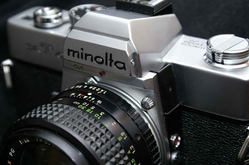

there is no stock picture here, both images were taken by me with a lousy old
rokkor 58mm 1.4 on my camera. i was hoping to find an opinion from someone who has actually used these lenses and understands their purpose. not the same old generalized assumptions.
heres the 58 1.4 on a camera
courtesy of e1/ zeiss 28mm 2.8

Photo showed late 50mm f1.4, 58mm f1.2, not early 58mm f1.4
The photo did not show a 1958 58mm f1.4 - it showed a mid-1960s 58mm f1.2, looks like a late example with Double Achromatic coating, and a 1970s MC 50mm f1.4 which definitely has Double Achromatic and is a superb performer. I believe the conversion of the mount is easier to do with the 58mm f1.2, and this does look like a late example.
The 58mm lenses - all of them - tended be quite low in contrast and with the original Achromatic coating (using two or three different thicknesses of single coating to correct colour shifts caused by the coatings) need good deep lens hoods to avoid serious flare issues into the light. They are really pleasant lenses to use for portraiture.
The 50mm lenses from the very late 1960s on have Double Achromatic coating, but seemed quite soft at the time compared to Pentax who had just introduced Super Multi Coating and were using it on some very simple lenses which hardly needed it - getting stunning contrast as a result. In 1974 Minolta began to multicoat their lenses, without saying anything much about it; the term 'Super Achromatic' was hardly ever used, or 'Multi Achromatic', but they stuck with the policy of using the coatings to get similar colour transmission across their entire lens range, rather than just to boost contrast and kill flare.
Canon used single coatings during Minolta's achromatic period and did little to balance colour. The moved to Spectra Coating (equal to Double Achromatic) a bit later than Minolta but made a bigger fuss about Super Spectra Coating - true multicoating - while Minolta never revived the emphasis they placed on their coatings in the 1960s and 70s. With the AF range they barely mentioned any aspect of the coatings.
Essentially - pre-1968, watch for low contrast and flare. Post-1968 - better. Post-1974 - often superb. Post-1980 - really not much difference between Minolta and any other make, all had got much the same glass and coating tech by then, but Minolta continued to make all their own from start to finish.
David

Sorry, I meant late 50mm f1.2 not 1.4 - that's such a rare lens that seing the rubber grip made me think f1.4. In fact I don't think I have ever seen a rubber-grip, last type 50mm MC f1.2 and I am pretty sure they never made an MD version.
I would not risk having the 50mm f1.2 converted to AF as I think it may have a high value left exactly as it is, for the future. Unless anyone can tell me otherwise? I never even saw one of these on a demonstration camera in the UK, and Minolta used to lend me all the best lenses they had - for example, 17mm f4, 21mm f2.8, 24mm VFC, 35mm Shift CA, 50mm f1.4, 100mm macro, 135mm f2, 80-200mm (first zoom) in the MC range. Never saw the 50mm f1.2 or I would have grabbed it to try out straight away.
The 58mm f1.2 looks like a late model in very good condition, and we know this can be converted permanently and accurately to fit the AF mount. I'd go for that one. It may be a bit less perfect in some ways but it gives you something close to having an '85mm f1.2' on the Alpha.
