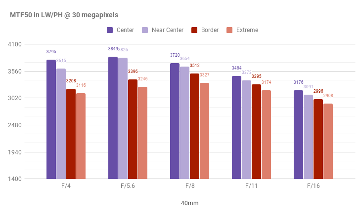

Line resolution of RF24-105/4 at 40mm

Here are the resolution measurements for both lens. (for the resolution charges, higher resolution is better).
RF24-105L/4.0 line resolution data from OpticalLimits
