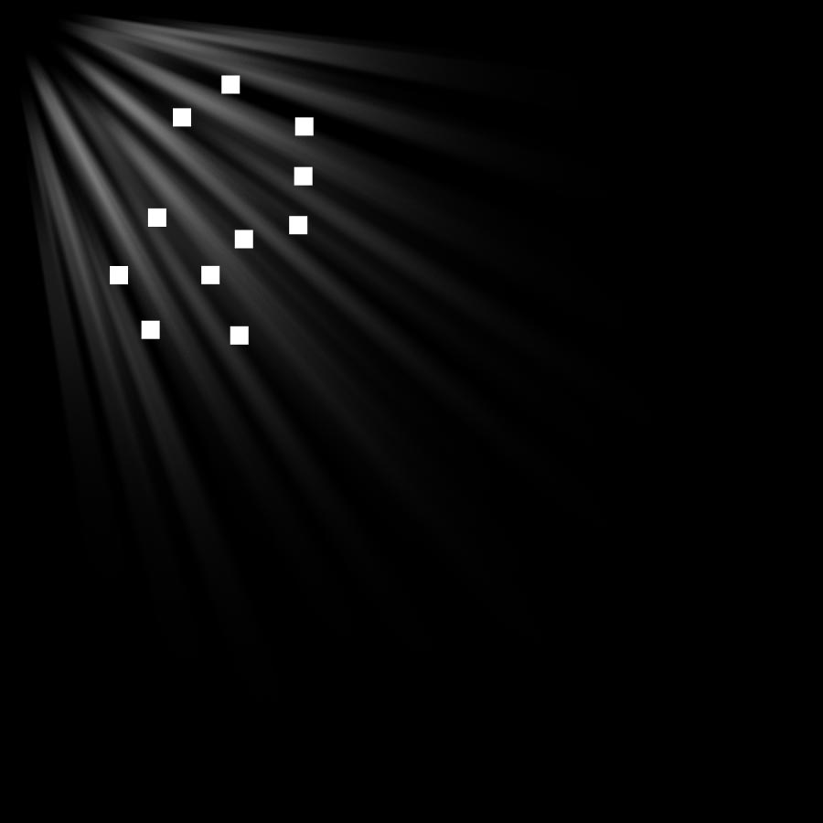

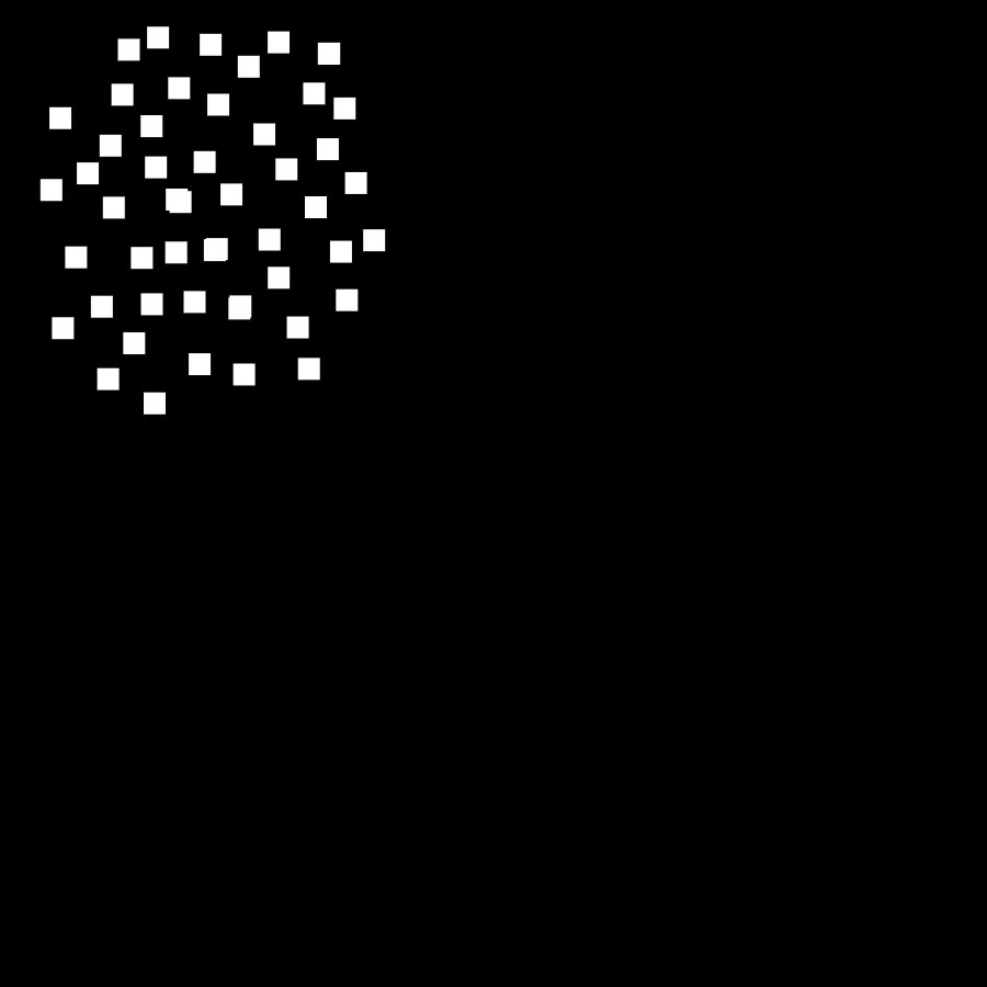

Create an empty black layer. Select a rectangular brush with hard edges and draw some spots.
Now blur the dots.
Radial Blur settings :
Zoom
Amount : 100
set the origin to the left top corner
Press Ctrl-F one or two times to strengthen the effect
Add some more squares and press Ctrl-F
repeat the process until you get what you want
Ctrl-J to double the layer and set the blend mode of the top layer to "color dodge" or "linear dodge". Alternatively you can use the levels adjustment tool Ctrl-L and play with it.
Now you should have something that looks like that.
The nice thing about this method is that you can carefully adjust where exactly you want additional light streaks.
