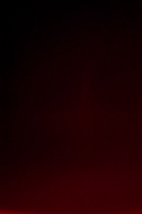

When shooting long exposures with the 18-200 the right side of my image (bottom of the image on verticals) would have an intense orange glow ruining the image. See images-
D300: 18mm, 27.5min @ 5.6, WB tungsten, ISO 200, auto noise reduction
D300: 18mm, 28.5min @ 3.5, WB incandescent, ISO 200, auto noise reduction
After determining that I had a defective lens, I mailed the 18-200 to Nikon for a repair. 2 1/2 weeks later I received the lens. But the problem was not solved or even improved. I decided to prove to Nikon that I had a defective lens so I took many long exposures with the lens cap on. I also took an exposure with a completely different lens. Here are the results-
D300: 18-200mm, 44min @ 5.6, WB auto, ISO 200
D300: 60mm prime Nikkor 2.8, 50min @ 5.6, ISO 200, WB auto
For definitive evidence I decided to procure a favor from my buddy who owns a local camera store. I borrowed his 18-200mm nikkor and did a long exposure with his lens. Results-
D300: 18-200mm (dealer's lens), 38.5min @ 5.6, WB Auto, ISO 200
At this point I called up Nikon. They told me to send my lens in for servicing. I told them that my lens had just been returned to me from Nikon. The rep looked up my service order and told me that my lens was up to standards, and therefore the warranty was not applicable. I told the man about the various tests that I performed and the results that I received. He was momentarily speechless when I told him that I used two 18-200mms and that both got the exact same strange orange glow. At this point he put me on hold. When he returned he told me that the problem might be attributed to the placement of the AF machine in the lens and how it retains very much heat. I then asked him what he recommended I do, and he essentially told me to live with the problem and there was nothing Nikon would do for me.
